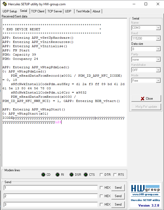

Now. I'm working with JN-AN-1217-Zigbee-3-0-Base-Device
Relate to end:  https://community.nxp.com/thread/438796
TB Coordinator project work well with UART1.
Then I want to use UART1 for transfer data in Router
I add more funtion to enable UART1 on Basic Router as Project Coordinator
    + app_serial_commands.c, app_serial_commands.h, uart.c, uart.h
app_start.c :: APP_vInitialise
main.c
main.h
Define in make file for enable UART 1 with baurate 115200
But have problem When printf data
Case 1:
It is OK ( Output UART1, Output UART 0)
Case 2:
It is OK! (Input UART0, Output UART 1)
Case 3:
Not work - Nothing to printf
I'm not defined 14, 15 for led
Is there a problem? Hope you help!
See my project:  GitHub - minhtan58 / JN-AN-1217-Zigbee-3-0-Base-Device
Thank a lot!

JN5169 UART1 SEND DATA
JN5169 uart1 Cannot send data to computer
I have config the same with Coordinator but still can't print data to UART1. What wrong with Router?

I have try many times, But nothing print when i send Data to UART1
Make file:
Sorry for the inconvenience ;((
