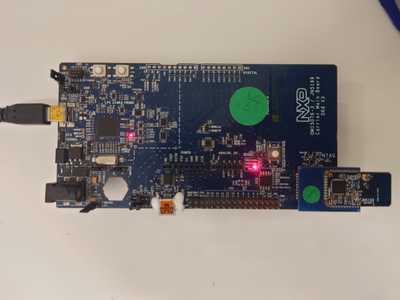

Dear NXP Support Team,
I am currently working with the JN5189DK6 development kit and attempting to flash and debug an OpenThread RCP image ( ot-rcp.elf) built from the OpenThread stack. I am encountering an issue where the debugger is unable to resolve symbols, specifically showing:
  • No source available for "main() at 0x5da"
Configuration Details:
  • Target MCU: JN5189DK6
  • SDK Used: SDK_2_6_16_JN5189DK6
  • OpenThread Version/Reference: Based on instructions from ot-nxp v1.4.0 README
  • Debugger: Segger J-Link (SWD interface)
  • Debugging Interface: Not using CMSIS-DAP (as mentioned in NXP guide)
  • Flashing Format: .hex and .elf
  • Debugging File: ot-cli-ftd.elf
  • IDE Version : MCUXpressoIDE_24.12.148
Steps Taken:
  1. Built the OpenThread RCP firmware for the JN5189 target with debug symbols enabled.
  2. Connected the Segger J-Link debugger to the board using the SWD interface.
  3. Loaded the ot-rcp.elf into the debugger for symbol reference.
  4. Started a debug session, but encountered the message:
  • Board configuration images
  • Debugging file (ot-rcp.elf)
  • Project configuration screenshots

Hello.
The issue you are seeing is due to the fact that the build is done using "MinSizeRel" option which strips the debug symbols.
To fix this, you need to change the following line: https://github.com/NXP/ot-nxp/blob/release/v1.4.0/script/build_jn5189#L40
from "MinSizeRel" to "RelWithDebInfo", rebuild the image and flash. Can you please try this change and provide your feedback?
Have a good day!

I’m currently facing several issues while setting up UART communication and debug logging for the JN5189 in my OpenThread Border Router (OTBR) environment. I’ve detailed the points below:
1) When I use the LPC-LINK2 port (even without the debugger, solely for UART communication), I encounter HDLC parse errors or framing errors shortly after launching the otbr-agent. In contrast, using the FTDI-USB UART interface works reliably, and the agent maintains communication unless exposed to heavy command loads.
I have attached the jumper setting when using the LPC-LINK2 port. (Refer to the attached image : Jn5189_Debug_port_jumper_config_.png)
2) I attempted to enable debug logs via USART1 (TX/RX on pins 10/11), considering the compatibility between K32W0 and JN5189. However, when I connect a USB-UART adapter and monitor the output via Minicom, no logs are displayed. Also, the otbr-agent fails to receive messages and eventually times out.

mihai_ignat
Hello, Vikash.
Regarding 1), the difference between routing the UART between LPC-Link2 port and the FTDI port is that on the FTDI port, the UART is routed to the FT230XS FTDI chip on the DK6 board, which translates the signals to USB on a more "hardware" logic, implying that it's done faster. On the LPC-Link2 port, the signals are passed through the LPC4322 chip, which acts also as a debugger probe and I suspect that it implies a more "software" approach, with more processing leading to some delays.
We haven't seen any issues using that port on our scenarios, but we do suggest using the FTDI port for real life scenarios, due to the limitations which I pointed out. One thing I can suggest to you is to switch the firmware running on the LPC Link2 chip. You can do this by putting the LPC in DFU mode (switch JP5 from NORMAL to DFU) and use the LPCScrypt software to do the change. A user guide is available in the link. You have the option to use the CMSIS or the JLink firmwares.
Regarding 2), I suggest using UART_USE_SERIAL_MGR instead of UART_USE_DRIVER. The changes I suggested in the post earlier should also be done:
