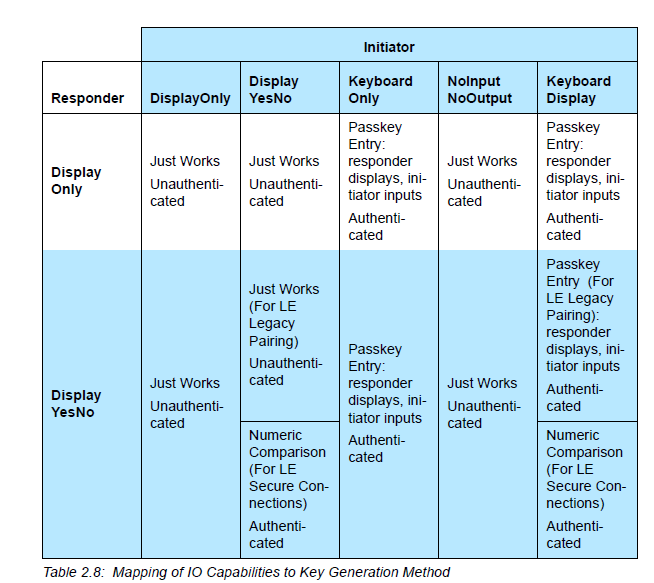

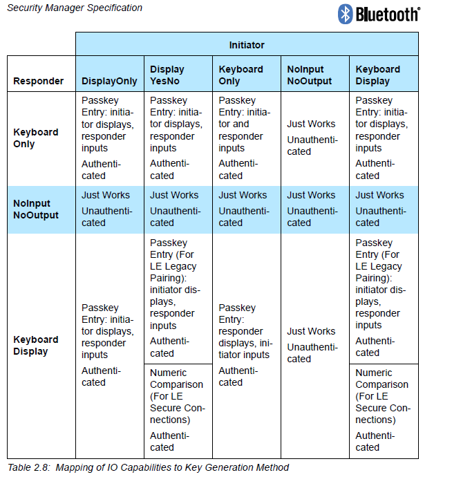

mario_castaneda
Hi Kishan,
It is possible. but the connections won't have MITM protection, it is unauthenticated
When IO capabilities is set to gIoNone_c, the key generation method is Just Works Unauthenticated. Please see below describe in spec.
The gSecurityMode_1_Level_4_c means Authenticated LE Secure Connections pairing with encryption, Authentication provides against MITM attacks.
Therefore, to have  LE Secure Connections pairing in Just Works, you need to set  securityModeAndLevel = gSecurityMode_1_Level_2_c to have unauthenticated pairing with encryption and set leSecureConnectionSupported = TRUE.
Please let me know if you have any further questions.
