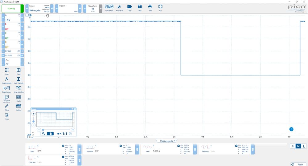

Ref : https://www.nxp.com/docs/en/application-note/AN13958.pdf
The above document provides a clear solution for initializing and testing Bluetooth modules of NXP Wireless module's bluetooth's host wakeup  feature . The same kind of solution book is not available for NXP wireless module's wifi / wi-fi feature .

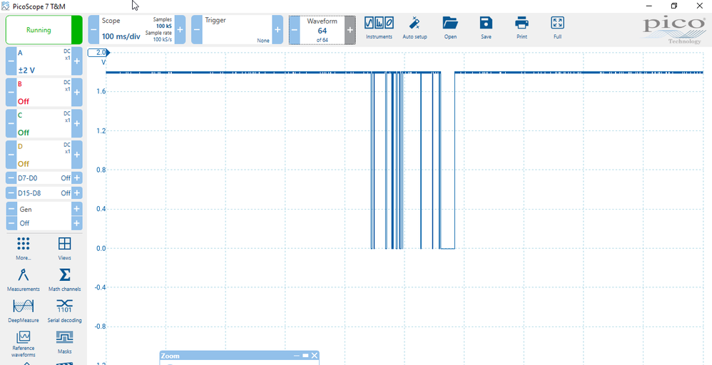

With the above steps , I was able to generate interrupts from the BL_WAKE_OUT pin if the BLE module detects any nearby BLE devices .
During the connection process , the interrupt signals were even stronger.
WAke up signals of BLE during scanningWAke up signals of BLE during scanningWakeup signals of BLE during connectionWakeup signals of BLE during connection
The Wi-Fi wake out pin does not produce any strong signals as similar to the bluetooth and unavailbility of tools that handles SDIO port is nil.
I have tried normal connection , wowlan's  magic-packet & tcp connection . both have failed to generate interrupt .
Am I missing something ?
