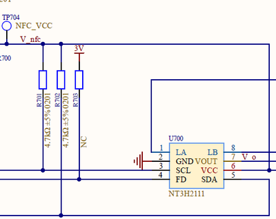

  There are 2 PADs from MCU connecting to I2C_SDA and I2C_SCL.
  R701 and R702 pull-ups to VCC:
  These 2 PADs are configured as GPIO input pull-up before NT3H2111 power on.

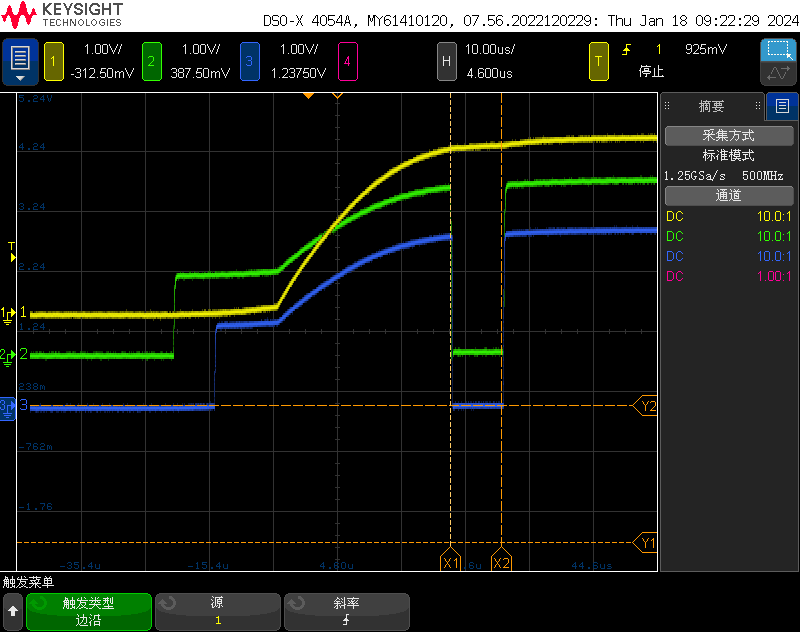

  The waveform of power on is shown in the following figure:
  Yellow: VCC
  Green: I2C_SCL
  Blue: I2C_SDA
   I found that there was a 10us drop at I2C_SCL and I2C_SDA during power on.
   How did this drop come?
  Thanks.
