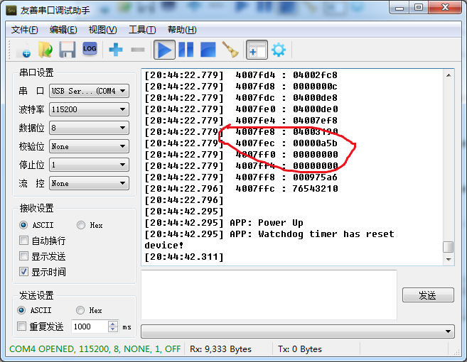

I used the coordinator to send data to the terminal node, which immediately stopped working (the entire node module stopped working).How do you solve this?
  • The data displayed by the serial port is as follows:
  • What does all this mean?
  • Why is the node not working?
  • How to start over?

mario_castaneda
The JN entered in a bus error. How are you sending the data?
Are you working on the JN-AN-1229?
Mario

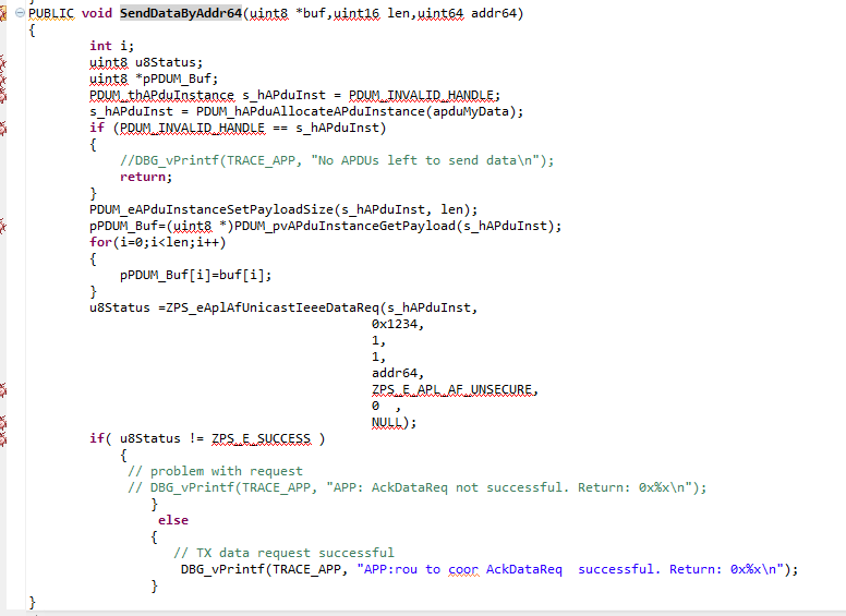

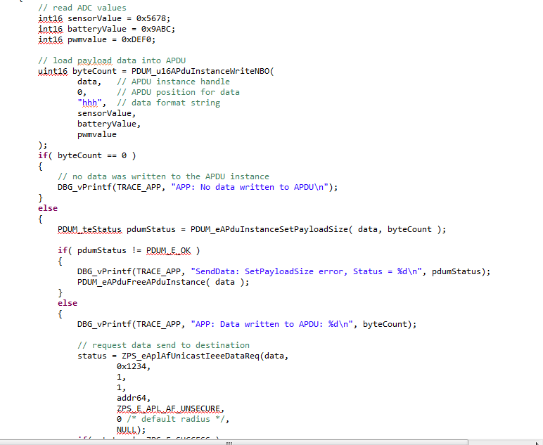

mario_castaneda
I was checking the code and you are missing the PDUM_u16APduInstanceWriteNBO. writes the specified data values into the specified APDU instance.
Please look at the code below.
       // allocate memory for APDU buffer with preconfigured "type"
        PDUM_thAPduInstance data = PDUM_hAPduAllocateAPduInstance( apduMyData );
        if( data == PDUM_INVALID_HANDLE )
            // problem allocating APDU instance memory
            DBG_vPrintf(TRACE_APP, "APP: Unable to allocate APDU memory\n");
        else
            // read ADC values
            int16 sensorValue = 0x5678;
            int16 batteryValue = 0x9ABC;
            int16 pwmvalue = 0xDEF0;
            // load payload data into APDU
            uint16 byteCount = PDUM_u16APduInstanceWriteNBO(
                    data,   // APDU instance handle
                    0,      // APDU position for data
                    "hhh",  // data format string
                    sensorValue,
                    batteryValue,
                    pwmvalue
            if( byteCount == 0 )
                // no data was written to the APDU instance
                DBG_vPrintf(TRACE_APP, "APP: No data written to APDU\n");
            else
                PDUM_teStatus pdumStatus = PDUM_eAPduInstanceSetPayloadSize( data, byteCount );
                if( pdumStatus != PDUM_E_OK )
                    DBG_vPrintf(TRACE_APP, "SendData: SetPayloadSize error, Status = %d\n", pdumStatus);
                    PDUM_eAPduFreeAPduInstance( data );
                else
Mario

jun951753jun951
  • I changed the function but the  bus error is still there
  • Only the terminal node will occur and this fault coordinator will not

jun951753jun951
I'm using 1229
Is the end device getting the bus error?   yes
Could you please confirm this process? yes i can confirm.
 Bus Errors occur when a  end device  receives and sends data continuously, not once.
Sometimes  end device can send and receive data normally for a period of time (from tens of seconds to minutes)
5,373 Views

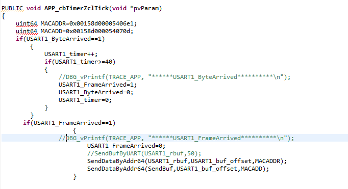

jun951753jun951
  • Called in the timer handler function.
