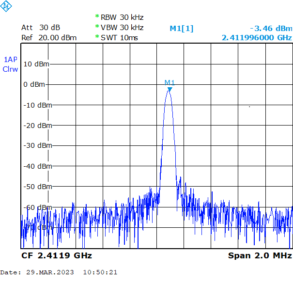

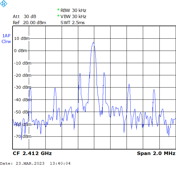

I am unable to generate a CW waveform. It seems to be a command problem.
I want to test by generating a CW (Constant Wave) waveform with the 88W9098, but I haven't been able to. It seems that the calibration is also done with the following command.
However, only a modulated waveform appears. I tried changing some boards, but it didn't work.
Rock 3a + EVK-JODY-W3
i.MX 8QuadMax + M2-JODY-W3
If you want to output only CW, the procedure is not very well written, so please let me know. Below is the input result.
I also put the observed waveforms.

Enter option: 6 11 0
DutIf_SetRadioMode_W909X: 0x00000000
Enter option: 112 0 0
Radio0 Mode = 11, Radio1 Mode = 0
DutIf_SetChannelBw: 0x00000000
Enter option: 12 0 1
DutIf_SetRfChannel: 0x00000000
RF Channel: 1 (2412.0 MHz)
Enter option: 35 0 1 1 10
DutIf_AdjustPcktSifs_W909X: 0x00000000 DeviceId=0
Power Level: 10.0000 dBm
Enter option: 35 0 0
Enter option: 18 0 1
DutIf_SetTxContMode_W90XX: 0x00000000
Enter option:

HiroakiOkoshi
I had feedback from inside . Thanks good guy.
The new version of the tool has the following description in the release note, so it was said that it was fixed.I tried and OK.
> Fixed Labtool command 18 procedure to generate CW tone.
W90xx (802.11a/g/b/n/ac/ax) TEST MENU
Enter option: 88
DLL Version : 2.0.0.89
LabTool Version: 2.0.0.89
FW Version: 17.80.200.224 Mfg Version: 2.0.0.63
SFW Version: 0.0.0.00 SHAL Version: 0.0.0.0
SOC OR Version: 1.d Customer ID: 0
RF OR Version: b.8 Customer ID: 0
