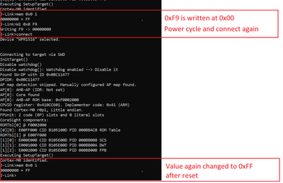

We are using MWPR1516  in our system. Now our customer requirement is to save parameters using the fixed-address section in MWPR1516 flash memory using the JTAG/JLINK interface.
From Segger's document, it looks like it does support such a feature. But I have done the basic experiments and when power is removed value changes to what it was earlier. I have even tried to erase the whole flash(0xFF) and tried to write 0xF9 at 0x00. But once I remove the power and again connect power 0x00 changes back to 0xFF. Please find below the procedure for the same in Jlink commander.

We have found a way to update flash using the Write command. It turns out that if first I update the RAM Address of that variable and after that default value of that variable using the W4 command, we get the expected result.

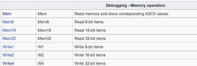

1) Can below command be used for writing on flash(0x0000 - 0x3FFF)?
2) Can we erase one page(0x0000 - 0x0200) and rewrite whole page using Write4(W4) command?
3) Is there more steps that need to be taken to write into flash in addition to the Write4(W4) command?
