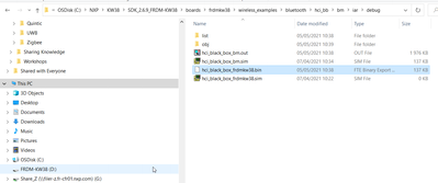

Part1: How to flash the HCI_bb binary into the Kinetis product (here is the example of the KW38).

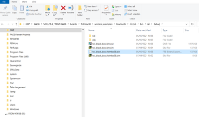

The HCI_bb application example is on the SDK folder below:
Plug the FRDM-KW38 board on your PC using the USB cable.
The FRDM-KW38 board will be seeing as a hard disk. Disk in this example.

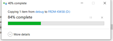

Select the hci_black_box_frdmkw38.bin file and drag and drop this file to the FRDM-KW38 (D:)
The KW38 is flashed when 100% is reached.
The FRDM-KW38 board is ready to be used with the DTM mode.
