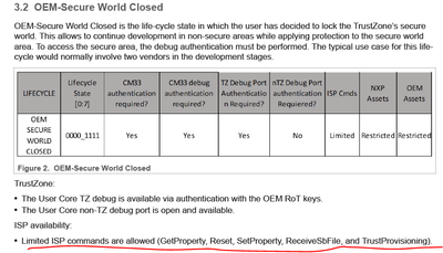

Now my "OEM_SECURE_WORLD_CLOSED" lifecycle KW45 can't run the application in flash that downloaded using ISP.  Which key will be used when KW45 secure boot in "OEM_SECURE_WORLD_CLOSED" lifecycle as the figure shows blow?

For the image send I understand that you ae following the guide for secure boot and this is great reference, but is also important to note that this examples and test cases present on the application note are using a life-cycle on OEM Open.
And it is also important to note that the ISP commands that can be used with
OEM_SECURE_WORLD_CLOSED are limited, I would like to know how did you downloaded the image with ISP commands this could be the reason why the image is not running as it should.

Do you mean that KW45 application firmware can't be updated with ISP Commands when lifecycle of KW45 is OEM_SECURE_WORLD_CLOSED, like the figure expained blow?  How can I run the application firmware when the KW45 change lifecycle to  OEM_SECURE_WORLD_CLOSED.
