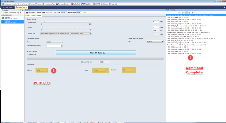

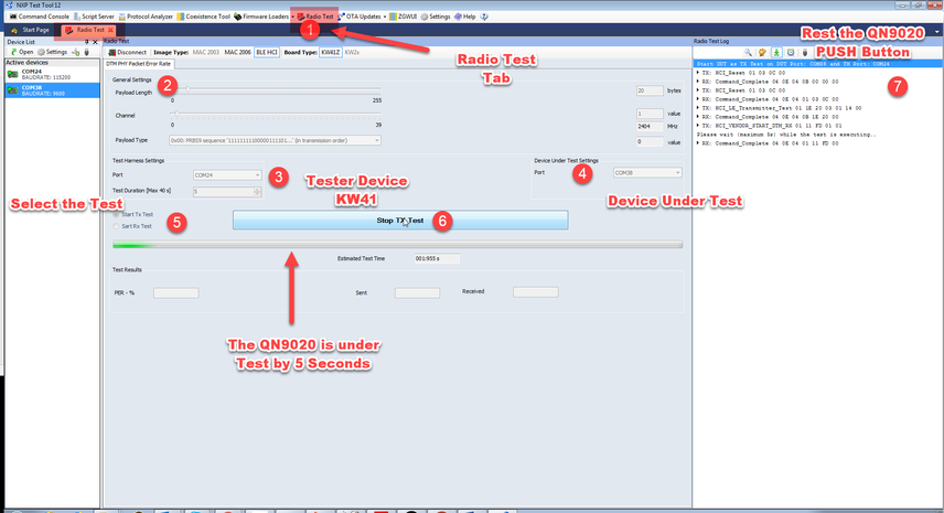

I ran some test by my side and I used
  • QN9020 Controller.bin (DUT)
  • KW41 HCI BlackBox (Tester)
Note: QN9020 can not take the tester role.

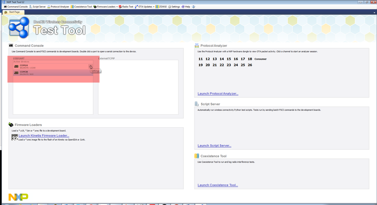

Please look at the image below, and look at the steps that I did to set the PER Test.
El KW41 has a baud rate of 115200
El QN9020 has a baud rate of 9600.
Then, you have to set the DUT and the Tester device.
Note: You have to press the reset button in the QN9020 Dev kit.
What is the Test tool Version that you have installed?

Thank you for your immediate response. We've manage to make a DUT good for FCC/CE test.
We have another concern regarding Test Tool 12, Is it usable for QN9021?
We have tried flashing our DUTs with controller.bin and used the Test Tool 12 to do DTM PHY PER at Bluetooth LE HCI tab and Board type set to KW41Z, we were not able to make it work? Can you advise us what to do?
