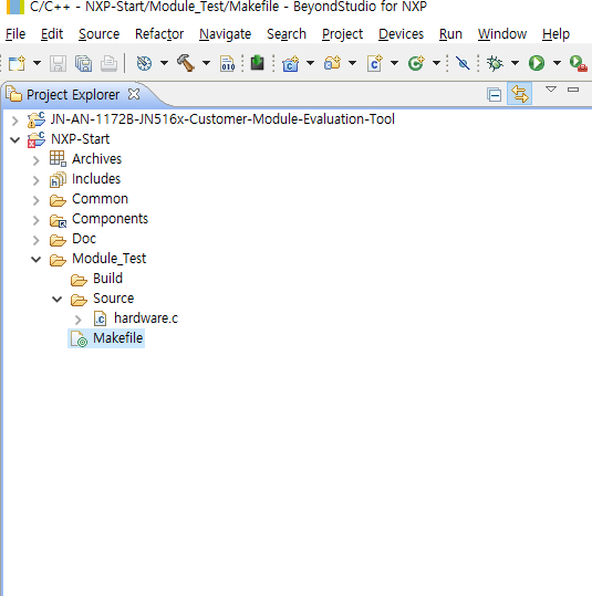

I have a problem.
I cannot start my project using this BeyondStudio for NXP.
At first, I imported a existing project, JN-AN-1174 (IEEE 802.15.4 Application Template),
and then renamed the project name as NXP-start. I made my folder "Module_Test" and copy a makefile from the sample folder and modify it. I attatched this makefile.
And then I Setup my project properties like following the picture.
After I clicked build icon, I cannot get any build files.

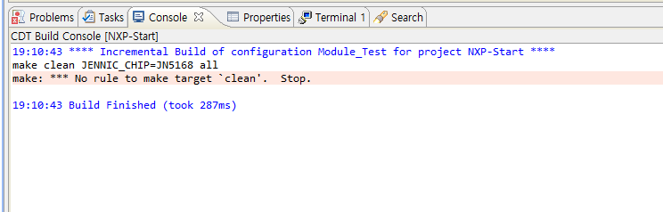

Console window show like this.
What is the problem?

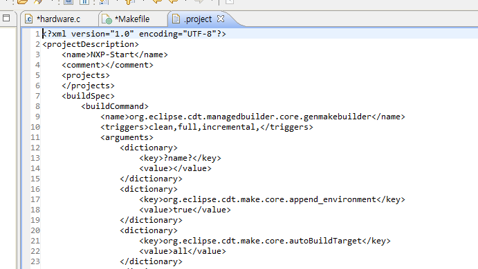

As like this picture, It was changed automatically. But I couldn't solve the problem.
Anyway, thank you for your kind answer.

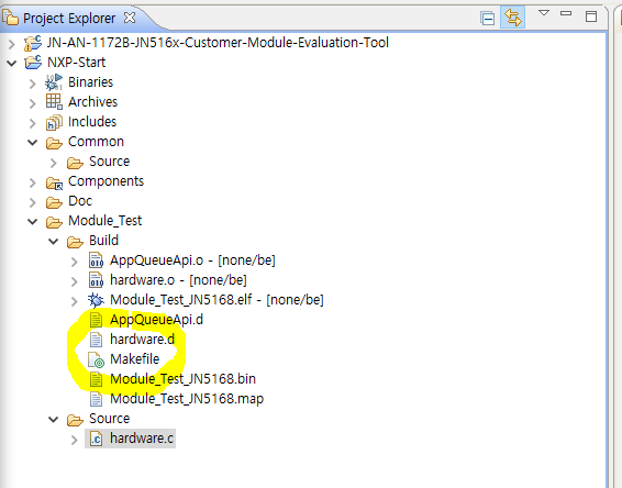

I found the reason why I could not go through.
Before makefile was in the folder of Module_Test, but I moved it into under Module_Test/Build that is originally setup Build location in the properties.
Now, I can build it.
