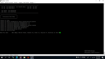

    Now we are developing a biluetooth board with KW45B41Z83, and we use connectiontivity Firmeve to control dut to do some RF test, and the test cmd as below:

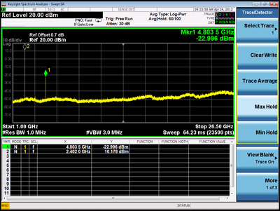

and Then SA to get the signal successful, The power of carrier Frequency(2402Mhz) is 10.1dBm.
But the 2nd Harmonic(4804Mhz) is out of the ETSI limit(-30 dBm/Mhz), our result is -22.9 dBm/Mhz.
So We want to ask you how can we restain the level of 2nd Harmonic in KW45 bluetooth design? Thanks.

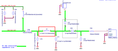

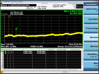

    Our default inductance value in Pi circuit is marking in the picture, 1.5nH. And now we try to increase the value of inductance in Pi circuit to 2.0nH. Then the 2nd Harmonic is decreasing to -34.3 dBm, and it will pass based on ESTI rules.
     But we want to get lower 2nd Harmonic to get the certification.  Would you mind sharing the target matching which is most suitable for KW45? We have test the 2nd harmonic of the KW45-EVK, the value is about -40 dBm, which is ideal for us. Thank you very much.

As mentioned in Compact Planar Antennas for 2.4 GHz Communication Application Note, Section 4.3 Impedance matching components, you can consult theKW45B41Z Evaluation Kit Board Design Files and use it as reference.
If re-tuning is required after using the EVK reference values, you could try replacing the series matching inductors with the next incremental values (up or down). You can adjust the tuning values as necessary.

    Now we have decresing 2nd harmonic by tunning matching, and now 2nd harmonic is about -39 to -45dBm. But tx power is decreasing 0.5 to 0.7 dBm, RX sensitivty is getting 0.7dBm better. We want to get a balance between RF performence and 2nd harmonic.
