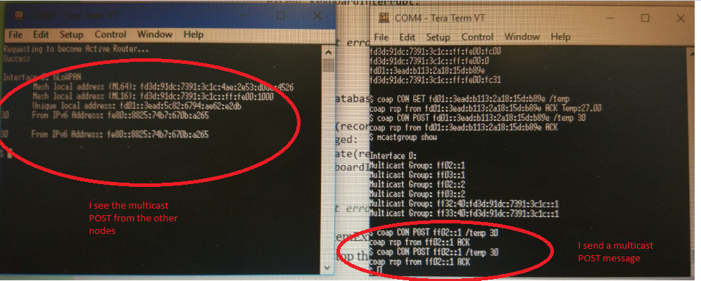

At this point I am perfectly able to communicate to my nodes when I make coap messages from my RP. However, I want to receive the multicast POST message that my Thread nodes send.
When I make a multicast POST request from a node, I am able to see the message sent in every node from my Thread network, but I am not able to see it from the Thread_Shell program of my host controlled device + RP with TAP.
There is any way to obtain the multicast POST message in my Border Router configured with serial TAP?

I have already solved the issue. The RP had the fd01::2 Ipv6 so I created a task in the KW41Z to send a Coap message to this IPv6 address. In order to receive the coap message in the RP I set up a CoAP Server in python attached to the Ipv6 address fd01::2.
