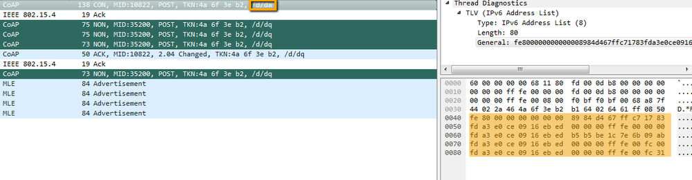

is there any way to get the CoAP IP addresses from the nearest Thread neighbors?
If I use THR_GetNeighborTable() I only get short and extended addresses.
Or: Can I send some simple messages to these adresses?
Thanks in advance.
Joachim

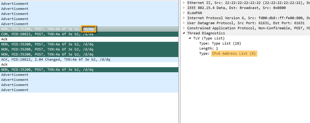

You can try $getnodesip shell command. This instruction will send a Get Diagnostic /d/dq message over the air asking for the IPv6 address list.
After receiving this instruction a node will reply with a Get Diagnostic Answer /d/da containing its IPv6 addresses
