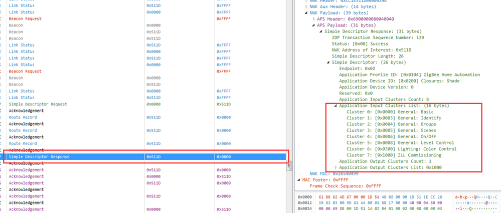

Hi everyone,
I have a PHILPS measuring color temperature lamp, reading its active endpoint and endpoint descriptor through a coordinator. The result shows that it does not have the 0x0702 clusterID; however, when reading the properties of clusterID0x0702, it reads and responds, and the power is displayed correctly. Why do you read the endpoint descriptor without the 0x0702 clusterID, and read the response when reading the attribute. Is PHILPS gateway able to recognize the 0x0702 clusterID itself and hide the clusterID from other gateways? If so, how do you configure to hide a cluster ID from other gateways?

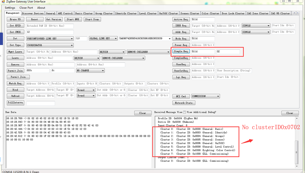

Here is my screenshot, Active req:
simple req:
No cluster ID 0x0702 for grabbing packages:

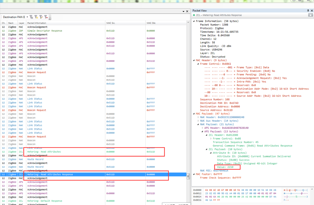

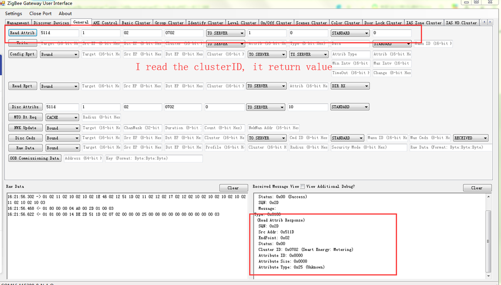

read clusterID0x0702 attributeID 0
clusterID 0x0702  attributeID 0    value:2210
Why can't you see the clusterID of 0x0702, but I can read its properties?  Cluster ID hidden? how to hide?

Hi Daniel,
Please be sure that your cluster is discoverable.
Mario

yuboli
Thanks , The cluster id is discoverable. When i set it false , Cluster ID cannot be seen.
When clusterID is hidden, is it still functioning? If it is functioning properly, why should it be hidden?

mario_castaneda
Hi Daniel,
If you have a lot of cluster in your endpoint, you will reduce some binding with these clusters or for your application purpose.
Mario
2,260 Views
yuboli
Thank you very much,       I  see
