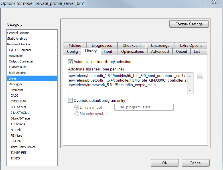

   I am connecting qn9080 with Android using Web Bluetooth, and I am not able to send more than 20 Byte at a single packet. while if I connect using a Desktop browser I can send more than 20 Bytes.
I searched regarding this MTU exchange and I found "GattClient_ExchangeMtu()" API is there which will initiate MTU exchange. I called this GattClient_ExchangeMtu() from BleApp_ConnectionCallback() , But the  GattClient_ExchangeMtu() is returning an error.
Can anybody help me on this to change the MTU size?

ExchangeMtu is best initiated by the Master (mobile phone or PC). If it must be initiated by the slave(QN9080), you can use the GattClient_ExchangeMtu() function, but the library needs to be modified.
lib_ble_5-0_host_peripheral_cm4.a -> lib_ble_5-0_host_cm4.a

Hi Xing,
     Thanks for your replay, it works. Now I am able to send packet more than 20 bytes.

     The gAttDefaultMtu_c  and  gAttMaxMtu_c values are same as you mentioned on the previous post.
I used GattClient_ExchangeMtu() to initiate the mtu request but it's returning an error number 4 which states's The requested feature is not supported by this stack version.
Do I in the right direction ?
