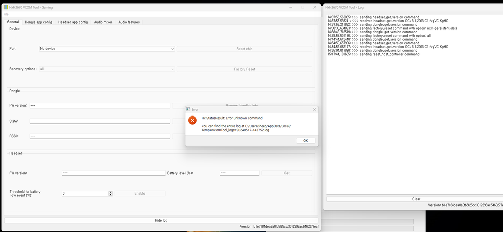

I am developing a project using NxH3670ADK's SDK (NxH3670 SDK Gaming Package). I tried to connect the ADK dongle to the SDK tool, but the process was impossible due to the error 'HciStatusResult: Error unknown command'. This error will notify you again after a while of the error 'HCI command timed out'.
This problem can be seen not only when the dongle is connected, but also when the ADK board is connected. However, the ADK board begins to be recognized by the VCOM Tool after flashing the firmware that built the 'kl_headset_adk_headset' project using MCUXpresso IDE.

At first, in vcomtool, both the dongle and adk board were visible in the device list, but when I selected them, the problem appeared as shown in the screenshot. Instead, the adk board worked as described in the text (the ADK board begins to be recognized by the VCOM Tool after flashing the firmware.... ) and then sent a response to 'sending headset_get_version command' from vcomtool. (3.1.2003.C1.NgVC.KgHC)

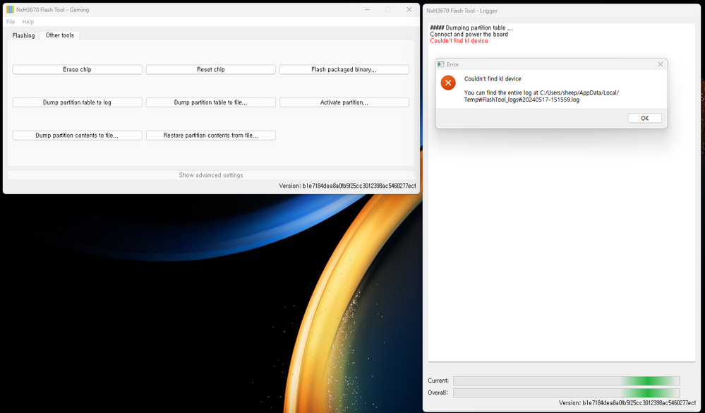

However, the dongle still did not work even though I connected the USB. (Error in screenshot) I would like to solve this problem using flashtool, but I cannot connect to flashtool. Currently, it seems that the dongle and board are not paired. There is still no audio.
The flashtool cannot be connected to both the ADK board and the dongle, but there is a way to flash the ADK Board using MCUXpresso using the J-Link Debugger. However, the conclusion is that there is no way to flash the dongle.
