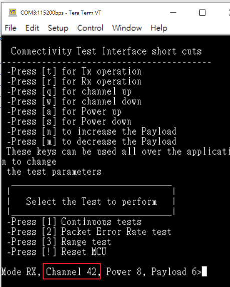

   Using KW41's GenFsk in MCUXpresso IDE environment.
    Research program can't find the last place to write register.
   Question:
   1. Channel range 0 ~ 127, what is the corresponding frequency?
   2. Where is the last place to write register in the program?

danieltseng
Contributor V

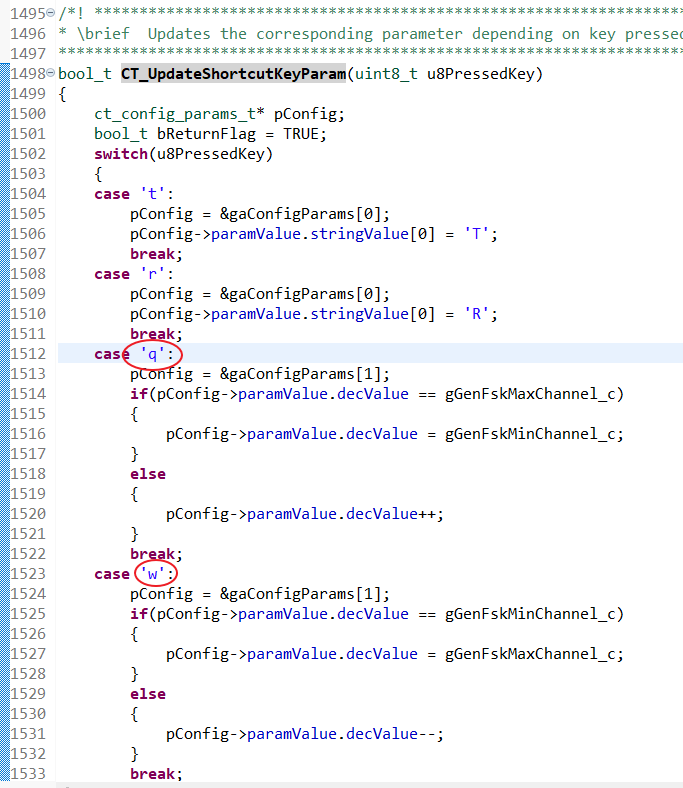

2. The structure of the program is not easy to understand, so can't find the corresponding function.
   2a. That is, when I press the "q" or "w" key, which function will be incremented or decremented ?
   2b. I want to know how to find this function?

estephania_mart
The code you are using works event based, so when you press a key .
Still , you can find in the gen_fsk_tests.c file the following line
GENFSK_SetTxPowerLevel(mAppGenfskId, gaConfigParams[2].paramValue.decValue))
I believe is the one you are looking for.
Estephania

Could you please help me with more details on the question 2? It is not clear for me what are you looking for.
Please remember that sometimes if you can't find an implementation of the function and you can only see the prototype function in the Wireless Connectivity Framework uses some pre-compiled libraries with the implementation of the libraries.
