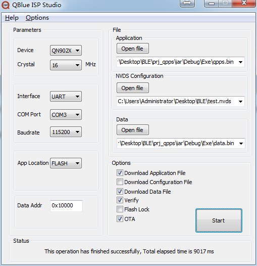

i have a 36kB application,17kB data file.ISP Studio setting as blow
but i get this error
how to slove it?

Hi Benny,

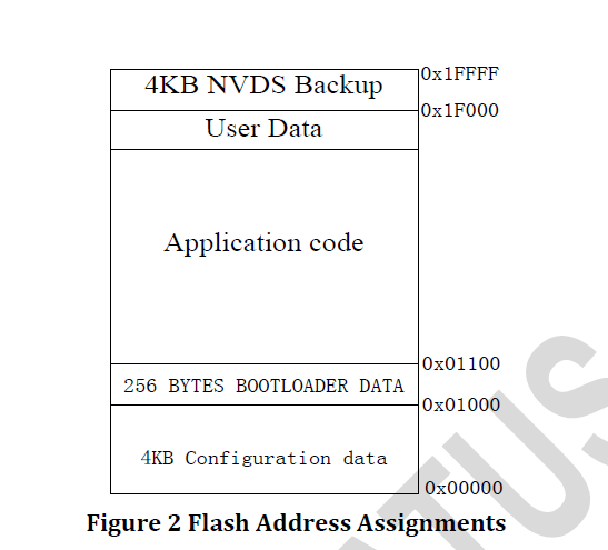

When you download a Data file into flash memory, this parameter will be used to specify the sector’s first address which data file stores in flash. If OTA check box is selected, this parameter’s value can be set from 0x4000 to the maximum value of flash memory. If OTA check box is not selected, this parameter’s value can be set from 0x2000 to the maximum value of flash memory.
So you don't have 0xF000 because you are selecting OTA profile, you only have 0xB000.
For a better reference you can take a look to the QBlue ISP Studio Manual
C:\QBlue\QN9020\QBlue-1.3.9\Documents
