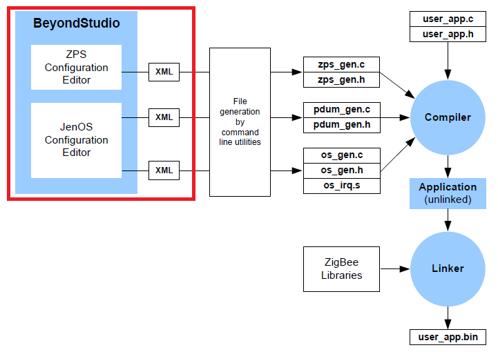

Dear everyone in community,
Currently, I'm stuck in creating new project using BeyondStudio for module JN5169. In JN-UG-3101 ZigBee PRO Stack
User Guide file, there is one page describing about full build process as the picture below.
As I understand, after configuration ZPS and JenOS, BeyondStudio will by somehow create XML files and with command lines it create itself generation files (zps_gen, pdum_gen, os_gen). But after configuration using 2 tools plugin in Beyond (ZPS Configuration Editor, JenOS Configuration Editor), I do not know what is the next step to build in to XML file and how to create these files (zps_gen.c, zps_gen.h, pdum_gen.c, pdum_gen.h, os_gen.c, os_gen.h, os_irq.s) by command line utilities. My zpscfg file is configured as the picture below and I also checked the validate of this file too.

Hi Nhan,
There is no need to convert zpscfg file to xml file. zpscfg itself a XML file. and with command lines utility following files will be generated.
Command line utility is available in Tools folder. command line utility should be called through make file.
I suggest to use any available Application note as a starting point.
