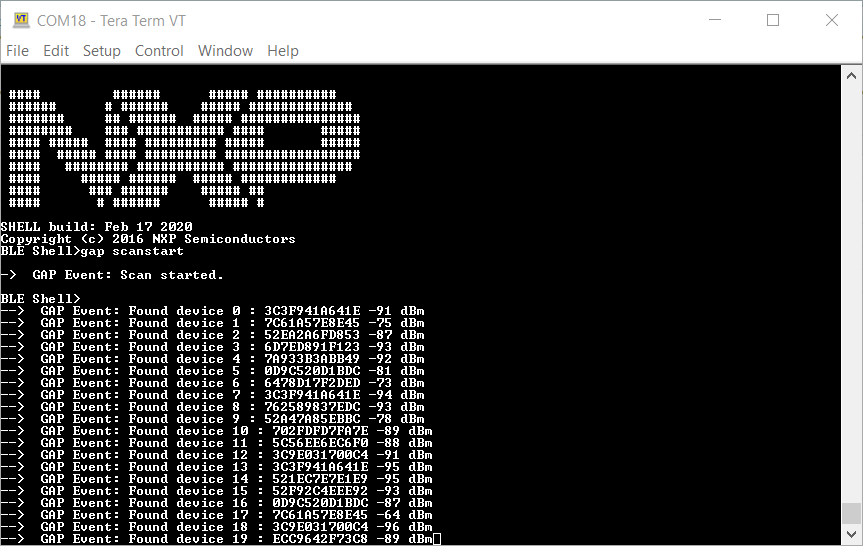

kishansaralaya
Thank you sebastian for the update,
BLE Shell example code scans for a peripheral in a one go, I do not see BLE scanning operation taking place after the defined configure scan window time.
In "Gap_StartScanning()"  configured  mScanDuration, mScanPeriod parameters and also configured "enableFilterDuplicates = gGapDuplicateFilteringEnable_c"
After these changes whenever I run the "gap scanstart" command output will be listing only 10 devices and it does not scan for the new devices.BLE_Shell_Scan_Window.png
 Kishan

Sebastian_Del_Rio
Hi Kishan,
By default, the BLE shell application (as well as some of the other demo applications) is configured to continuously scan for advertising devices until scanning is disabled.
If the value for the scanning window is changed from 0 to any other value, then the scanning will take place only for the time it was configured for.
If you leave the value on 0, could you please check to see if you can scan more than 10 devices?
Please let me know if you continue to have issues.
Sebastian
2,904 Views
kishansaralaya
Hi Sebastian,
  Figured out the reason for scan get stopped after finding 10th BLE device, the reason for this is the configuration value set for   enableFilterDuplicates = gGapDuplicateFilteringEnable_c , If we disable DuplicateFiltering controller scans for the peripherals in a continuous mode.
Thank you,
  Kishan
