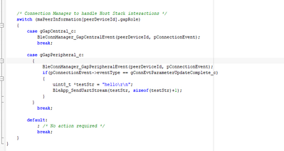

hello
The specific program I use is "wireless_ uart"。 Normally, I write data in Tera term, and then press "Ctrl + enter" to send data to my mobile phone, but now I have written some data in advance in "wireless_uart" Why do I still need to press "Ctrl + enter" in Tera term?
  I hope that when I supply power to the development board, it can automatically send my written data to my mobile phone.
   So, which function is triggered by pressing "Ctrl + enter"? How can this function run itself without the trigger of Ctrl + enter?
thank you.

Please refer the picture. It will send 'hello' when mcu connect to the phone. You needn't modify the uart code.

     Let me elaborate: first of all, I'm at "BleApp_ Flushuartstream" defines a one-dimensional array. Then connect the software "teratm", press "Ctrl" and "enter" on the keyboard, and the one-dimensional array I defined will sent to my mobile phone.
     Now, I hope that when the development board is connected to the mobile phone, "BleApp_ Flushuartstream "can run automatically, without the need for software" teraterm ".

I appreciate your help! thank you!
