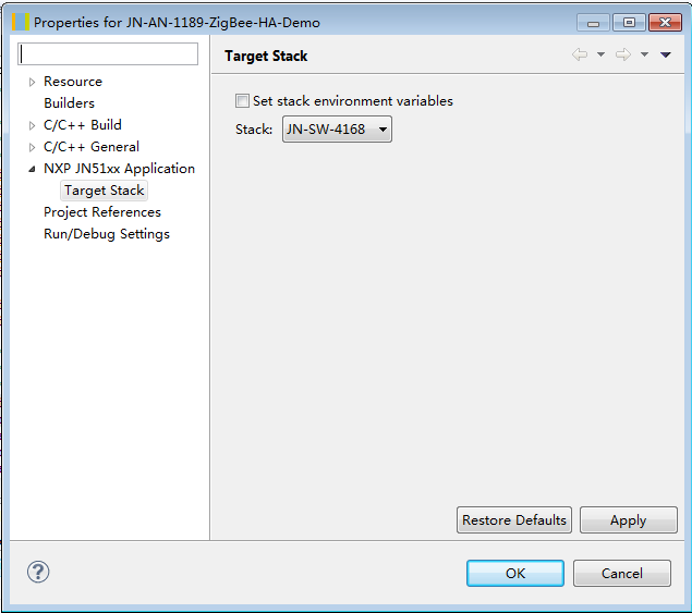

After you select th JN-SW and you apply it.

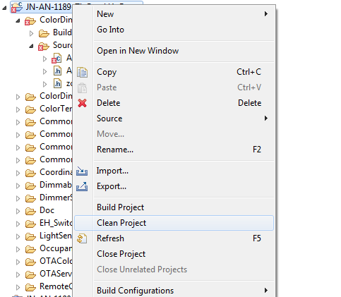

Then you have to clean the project

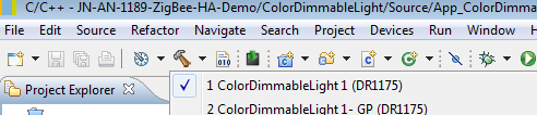

Next select the button for building the project
