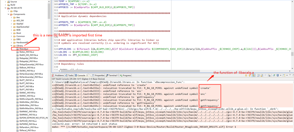

Hello, I have a question now.How I added a new static library (libacalg.a) to jn-5169.And how do I use it?How do you call a function inside that doesn't compile wrong?Could you give me a demonstration or an example?Thank you so much!

You could try adding a reference to your library in the makefile for the project, however, it's not guaranteed that the compiler will support adding custom .a libraries.
Could you please let me know what your end application is? So I can see if there are alternatives to adding this custom library.

Are these functions defined with external linkage in that library?
