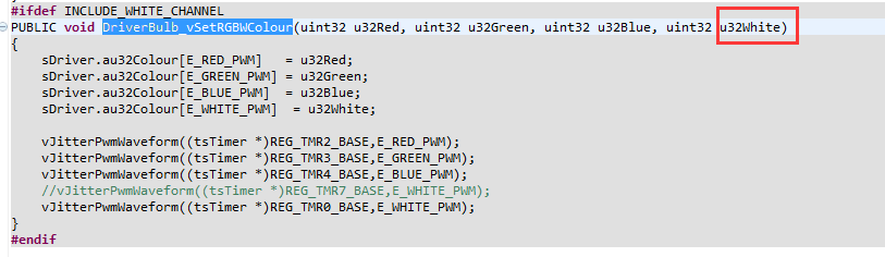

yuboli
Thanks ,
         Do you use the following function?
but  u32White is not know. so I Cannot call  DriverBulb_vSetRGBWColour()?
4,763 Views
Sebastian_Del_Rio
Hi Daniel,
Unfortunately, since support for RGBW lights is not included for all of the devices, the implementation for the device you're using is custom, and the function provided is only for reference purposes.
To use an RGBW light, you will have to implement another channel for the W value, based on the way the DriverBulb function did it.
I'm sorry for the inconveniences this may cause.
Sebastian
