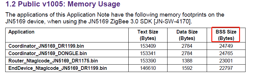

The JN5169 with 32k ram, but after with JN-AN-1217, how much ram is left to use?

Please look at the Release document in the Doc folder of the AN.
"C:\NXP\bstudio_nxp\workspace\JN-AN-1217-Zigbee-3-0-Base-Device\Doc\JN-AN-1217-Release-Notes.pdf"
1.2 Public v1005: Memory Usage
However, you could use StackMeasure.c file
STACK_MEASURE          ?= 0

There is another question asking you,In the following picture,Is "BSS Size" the RAM size occupied?

The BSS contains all the uninitialized data, this information ends up in RAM.
