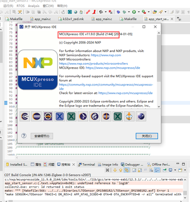

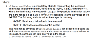

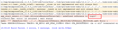

In obtaining the value of illumination, it needs to obtain the measured value by logarithm. But I write it this way, but the compilation error.The header file math.h is already included
How do I solve this problem?

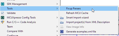

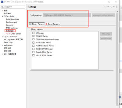

In the meantime I can suggest some steps in order to solve this
Can you please try to fix the parser
And please let me know if this help you out with this problem.

Tome-mbedded
hi nxf77486
Thank you for your reply
I'm using nxp's JN5189 chip.
The IDE version is MCUXpressoIDE_11.8.0_1165
The SDK Version used is Release Version:2.6.12 JN5189DK6)
The routine I use is JN-AN-1246
I tried to fix the parser the way you said. After the repair is complete, recompile and report the same error. Is there any other way to solve this problem?

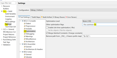

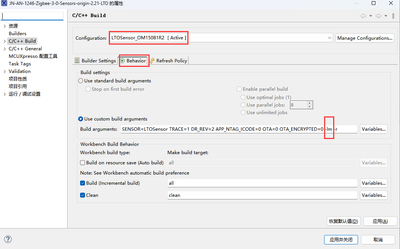

Can you please help me to add the following compilation flag  "-lm".
And please let me know if this help solve you issue.

Tome-mbedded
hi,
Where to add this compilation flag?
I added in the following position, but the compiler reported the same error
3,578 Views
nxf77486
Sure, can you please add the compilation flag on the following location, and please let me know the results.

Tome-mbedded
hi ,
My IDE cannot find this option, what should I do?

hello,
I updated the IDE version, but I couldn't find this option, and the compiler still reported the same error. How else can we solve this problem?

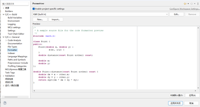

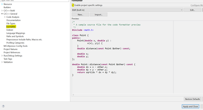

nxf77486
Thank you for the change on the MCUXpresso IDE.
I understand that the view is different, but in this ZigBee example can you please help me by opening the C/C++ General and go to Formatter view you should see something similar as the image attached, please click on Enable project specific setting and then Apply an close.
Please let me know if this worked.

Tome-mbedded
thank you,
I followed your steps, but the compiler reported the same error
