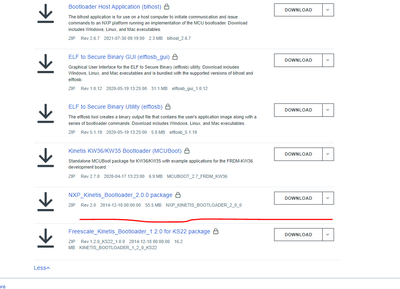

Please go to this link. And download this package.
The tools is in 'NXP_Kinetis_Bootloader_2_0_0\bin\Tools\KinetisFlashTool\win'
