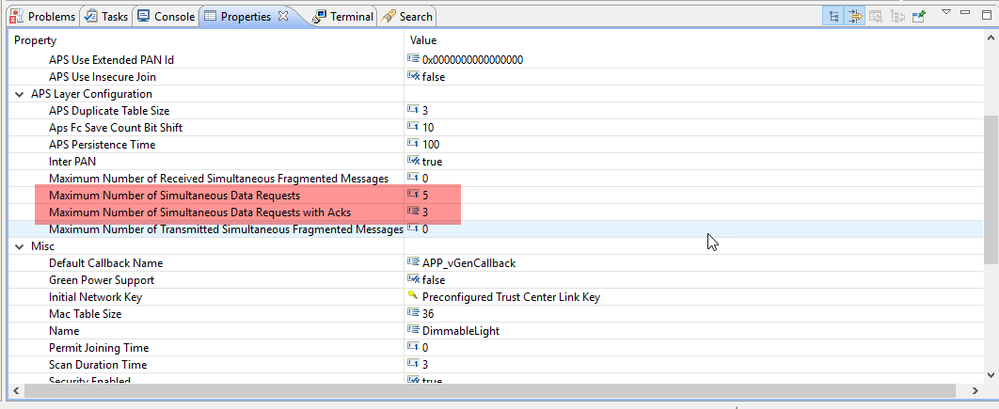

Hi, Im using JN5169, SDK 4170. When checking zigbee performance I get some errors ZPS_XS_E_NO_FREE_SIM_DATA_REQ, ZPS_XS_E_BAD_PARAM_APSDE_REQ_RSP after getting 0xD0 (
ZPS_NWK_ENUM_ROUTE_DISCOVERY_FAILED
). These erors I get from callback of ZPS_vExtendedStatusSetCallback.
I don't know how to handle this error. Please help me.

The ZPS_XS_E_NO_FREE_SIM_DATA_REQ is because you do nor have free simultaneous data request.

I set both of 2 parameters to 10. But sometime I have still get this error.

Maximum Number of Simultaneous Data Requests Should be set to the maximum number of target nodes in one bound transmission. Both errors that you are getting are related.
