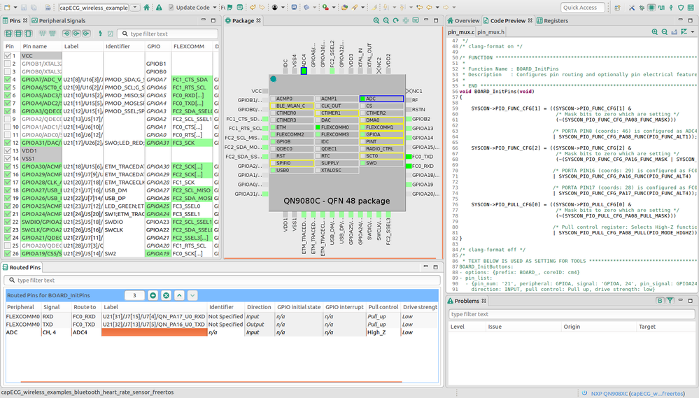

I'm using the evaluation kit for QN9080 and I want to use one channel for the ADC. I used the config tools for pin configuration in MCUxpress IDE and selected channel 4 which is routed to GPIOA8/PA08 . However when I give an analog signal on PA08 of the evaluation kit, I don't see any changes.
I did refer to the developer manual which only says that GPIOA8 is routed to PA08
Can someone help me what else needs to be done in order to make it work?

My configuration is as shown in the pic below:
When I apply an analog signal at GPIOA8 (PA08), the output I get is 29700. It's a constant output. Expected output should not be a constant value.

estephania_mart
Are you debugging your project ? Are you sure it is working correctly ? Could you please help me confirm that there is no hard fault or bus fault ?
Also, are you sure that none of the initial configurations of the project have been replaced by your config tools usage ?
Could you please check the temperature_sensor example? I believe that if you use that example as a base with wireless functionality might be a best option for you.

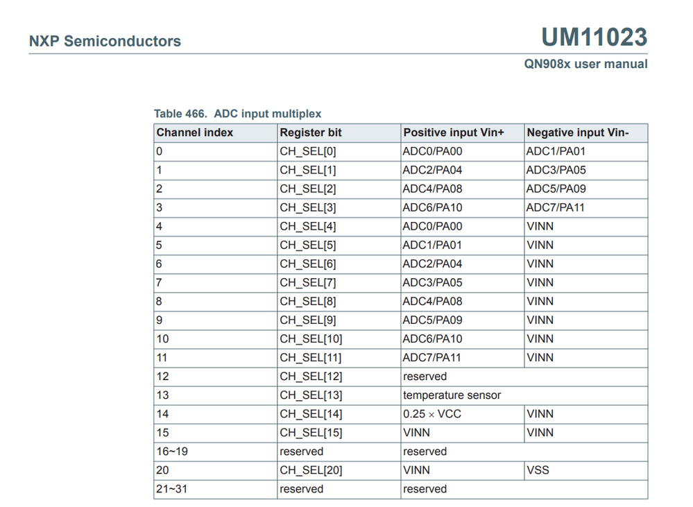

smittal2
Estephania,
The temperature_sensor example has #define ADC channel 13 routed to ADC4. I don't understand how that's possible.
Can you please explain? I think I'm unable to route the pin to correct ADC channel.
For example,if I want to use ADC4 channel then should I set the bit in the channel as (1U << 4) ?

smittal2
Thanks Estephania for your help, I'm now successfully able to configure the ADC based on the information provided in the table 466:
