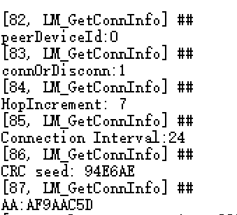

I use a KW38 as a peripheral, and then connect it to four KW36 units via CAN. After connecting an Android phone to the KW38, I obtained the related listening information for genfsk as shown in the figure below. The four KW36 units can obtain the masterRSSI, which I believe refers to the Received Signal Strength Indicator (RSSI) of the heartbeat packets from the Android phone.

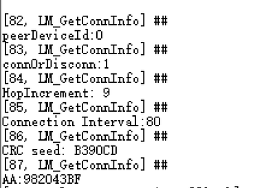

However, when I use an iPhone, with all other test conditions remaining the same, the genfsk information obtained is as shown in the figure below. At this time, the four KW36 units are unable to obtain the masterRSSI.

After I connect my Android phone to the KW38, it conveys parameters such as hopIncrement, crcSeed, syncAddress, connection interval, and channel map to the KW36 device via CAN. Once the XCVR_GENFSK_ENABLED and related features are enabled on the KW36, the GENFSK_InterruptHandler interrupt callback can detect the masterRSSI and slaveRSSI. This process is seamless when I use my Android phone. However, when I switch to an iPhone, the conditional check if (irqStatus & GENFSK_IRQ_CTRL_RX_IRQ_MASK) doesn't seem to be triggered, suggesting that packets may not be captured. The access address and crcSeed I transmit to the KW36 appear to be correct upon inspection, and there are no obvious anomalies. Could you shed light on what might be causing this issue?
