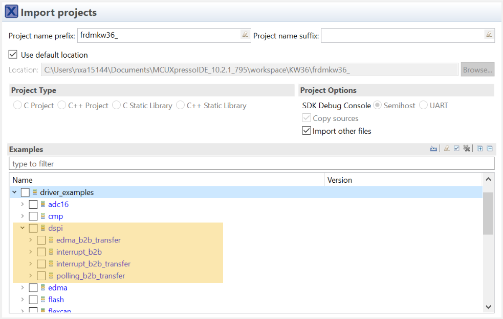

I am using FRDM KW36 development board. I want to do study of SPI driver which example is helpful for do study about SPI driver.

estephania_mart
I believe you will find helpful the example available in the SDK of the KW36, by any chance, have you checked it? Is it helpful for you? Do you have any specific doubt regarding it?

abhitippanna
I am using FRDM KW36 development board and i am going to interface on board flash present on development board using dspi polling example.
how that should be done..?
3,154 Views
estephania_mart
If you want to run the example as it is set by default without any modification, you will need two boards. One to work as a master and the other one as a slave, connect them as stated in the readme file in the examples and just run it.
