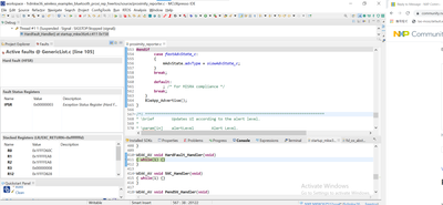

Lincoln
Hi @mario_castaneda ,
Thanks for your advise, but here comes another problem. After I add the init hardware code about Print API and run it again, it shows this fault below when i connected to IoT Toolbox, then it loss of connection immediately.
(My code is attached below)
7,797 Views
mario_castaneda
Hi @Lincoln,
You have to initialize the clock and the UART pins. Please look at the wireless uart example or the QPPS as a reference for this setup.
Mario

Lincoln
Hi @mario_castaneda,
Thank you for the response, the fault issue is resolved and the connection is stable. As I ask previously, I want to monitor the Rssi value on the console, I checked this function: Gap_ReadRssi(peerDeviceId) is working successfully, but it is always printing Rssi value as zero on the console.
