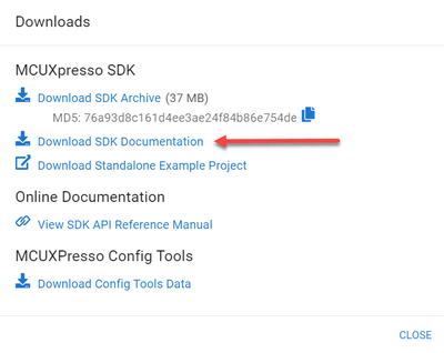

KW38 SDK documentation can be downloaded from the MCUXpresso SDK Builder, after building the SDK and when download dialog is shown:
