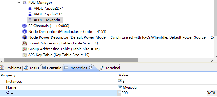

I am a novice in JN51 and I have encountered the following problems recently. Thank you very much for helping me  .

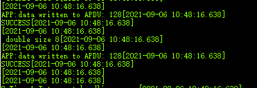

No errors when I send 15 doubles data  or 14 doubles data at a time ,15 doubles data  result:
errors when I send 16 doubles data  or 14 doubles data at a time 16_doubles.PNG

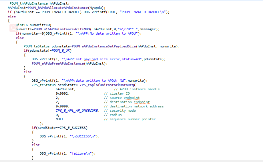

code:

You have more options if you select your device and in the properties path the advance options.
What I want to know is  the maximum number of bytes  can be written to an APDU at a  time,How to achieve it?

What is the value of your numwrite value?
However, please look at the B.1 Fragmented Data Transfers that explain a little bit more the process that you want.
