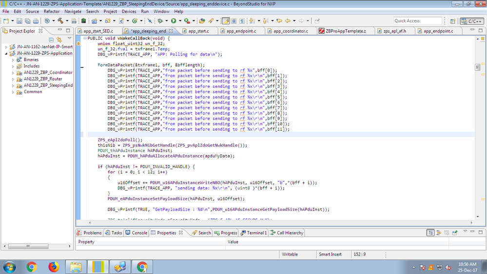

i am working on JN5168-001-M00 module.
i am trying to send data from seeping end point device to coordinator.
i achieved data transferred between this two module.
but problem is that my updated data is not updating on Coordinator side.
example, i want sending temp value to coordinator from sleeping end point device, only my first packet is got send correctly but if temp is change on sleeping end device is not shown on coordinator device.
i really dont know what should i do.
please need your help.
i am attaching picture so you will understand better2nd packet.pngfirst packet.png

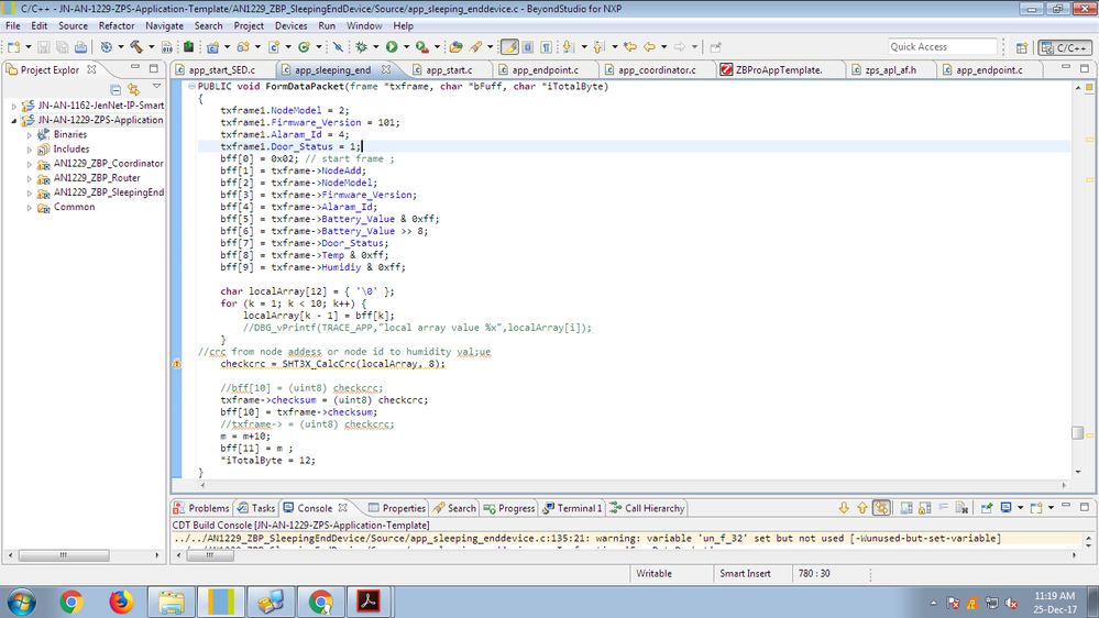

mario_castaneda‌  , davidashraf‌ , LimLim, ‌ lim22983@gmail.com‌.sed device2.pngSED Device part 3 (description of from data packet function).pngcoordinator device1.pngcoordinator device2.png
Still i Didn't find out any solution for this.
Please need your help.

Hi Dheeraj,
Did you try the attributes report? The binding process will help you a lot.
What is the maximum time that you want in sleep mode?
Could you please confirm this?
Mario
