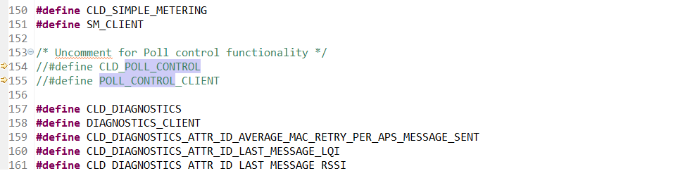

By default, Poll Control functionality is disabled. Have you enabled this functionality?
Go to lines 154 and 155 in zcl_options.h and uncomment both lines to enable it.PollControl.png
Please let me know if this fixes the issue.

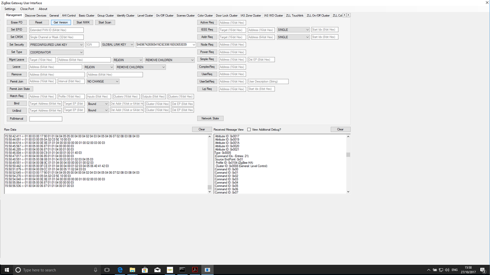

I'm just coming back to this having been moved onto another project for the last few weeks.  Unfortunately, what you suggest doesn't seem to work.  I compiled with these two lines uncommented but when I connect with the ZigBee Gateway User Interface, it seems to go crazy, just spewing out tons of output as shown in the screenshot below.  This continues until the UI eventually crashes.  The problem definitely appears to be due to these two lines as when I comment them out again and recompile, everything returns to normal.
In addition, when checkin messages are received, what format will the messages be in?  I don't see anything in the ZigBee IoT Gateway Control Bridge documentation about what the message type would be or the format of the payload?
