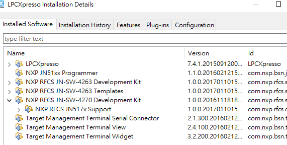

I'm developing ZB30 application for JN5179, and want to use ZPS configuration editor as JN-UG-3113 described - to found it under "Jennic option". But I cannot find it in "LPCXpresso_7.9.2_493"
I have installed the newest JN-SW-4263 and 4270 as below.
Can you make a suggestion where is the problem? Thanks!
In "JN-RN-0062-JN-SW-4270-JN517x-ZigBee3-SDK.pdf" (v1520) says:
Software Component contains "ZPS Configuration Plug-ins  [v31504]". So where can we find it?

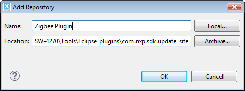

-Please follow the path Help > Install New Software….
-In the Available Software screen, click the Add… button. The following Add Respository window will be displayed.
-In the Add Repository window:
file:/C:\NXP\LPCXpresso_7.9.2_493\lpcxpresso\sdk\JN-SW-4270\Tools\Eclipse_plugins\com.nxp.sdk.update...
-In the Available Software screen, expand Jennic ZBPro SDK and ensure that the checkboxes for Jennic RTOS Configuration Editor and Jennic ZBPro Configuration Editor are ticked. Click Next > to continue
-Continue following the step 6

It works and got as below wizard. Thank you!
It is the same procedure as Danny described in Section 1.2.2 of JN-UG-3109.
Just wondering why my previous installation of JN-SW-4270 did not include this? I rember to have followed Section 3.2 "SDK Plug-in Installation" of "JN-RN-0062-JN-SW-4270-JN517x-ZigBee3-SDK.pdf", but only to found "All items are installed" message displayed under "NXP RFCS JN-SW-4270 Software Development Kit".
