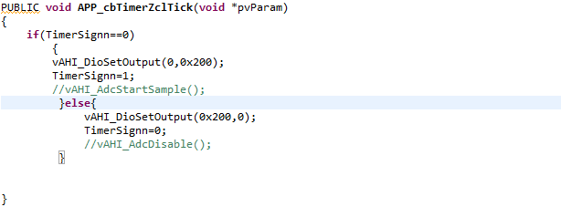

  • I set it at 500 milliseconds but the actual time is 5 seconds
    • Does the ticking timer have anything to do with system hibernation? How to set it
My configuration:
manipulation function:
A serial port display:
APP: Going to sleep (CB)
1 返信
1,105件の閲覧回数
mario_castaneda
Is the ZTIMER_eStart returning E_ZTIMER_OK value?
Could you please add in your code a serial debug print?
Please look at the JN-AN-1218, The timer button scan implementation for a better understanding.
