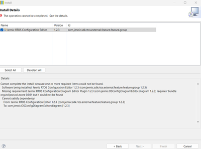

The problem was that the Eclipse wesbite could not be found. So I had to manualy download and install them according to THESE instructions of your post from last year. Still the "Jennic Rtos Configuration Editor version 1.2.3" cannot be installed. Is that a problem?

7,062件の閲覧回数
EduardoZamora
Eclipse cloud has changed the structure of multiple dependencies packages in their repository, making older plugin versions no longer available for Beyond Studio IDE.
