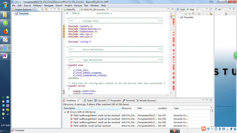

BeyondStudio for NXP 中 C/C++Build项下Tool Chain Editor 是否需要配置?目前问题是导入例程一堆错误

新安装BeyondStudio for NXP,导入例程无法编译通过

The errors you are seeing is Eclipse not being able to resolve various variables and functions within the SDK. You can delete that errors, Look that he Console Path and try to compile again, only see the process in the console section.
