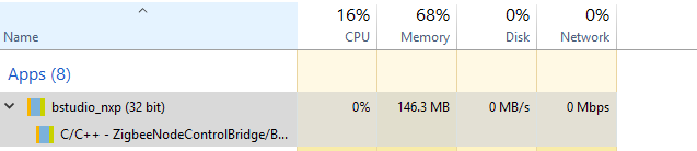

I am using beyond studio to build zigbeePro application. The build process is too slow. If a single file is modified it takes around 4+ minutes. For a clean and build of the ZigbeeControlBridge Sample code, the ide takes 35+ minutes.
The PC I am using is an i7 with around 8 GB Ram
Task Manager shows the following
the content of bstudio_nxp.ini is as follows

You have a lot of factors that are affecting your compiling process, is your CPU doing other routines? Do you have enabled your antivirus that is checking all the write and read process?
I am working with the JN-AN-1229, I cleaned and build the coordinator process and it takes 45s 372ms
The task manager shows the following, but remember Beyond Studio is based on the Kepler release of the open-source Eclipse IDE, and as you know Eclipse takes a lot RAM, so it explains in my case the 144MB.
Please let me know your findings.

when I am building this is what I am getting in the task manager. CPU usage keeps changing ...
and for a build without clean it takes around 6 mins. I am using the demo code without any alterations.
