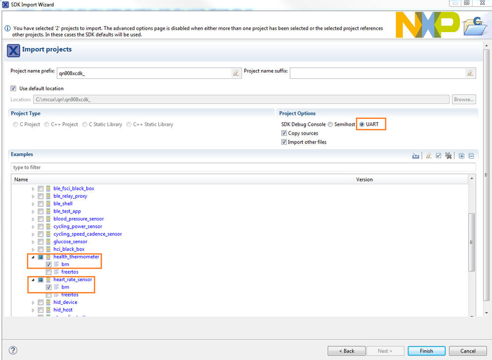

I am facing issues with latest KW41Z SDK. Please let me know your inputs. I was going through below link for installation.
https://www.nxp.com/products/processors-and-microcontrollers/arm-based-processors-and-mcus/kinetis-c...
 I am facing issues in compiling example code. Below are my queries and steps followed.

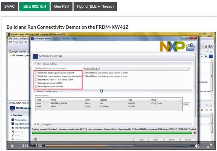

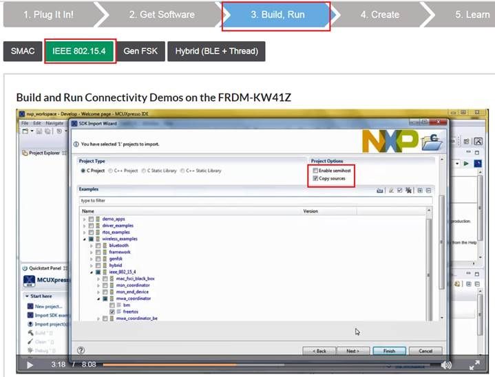

1. As per video IDE is of version “MCUXpressoIDE_0.0_344.exe”. But when I download, it is of “MCUXpressoIDE_10.1.0_589.exe” version.

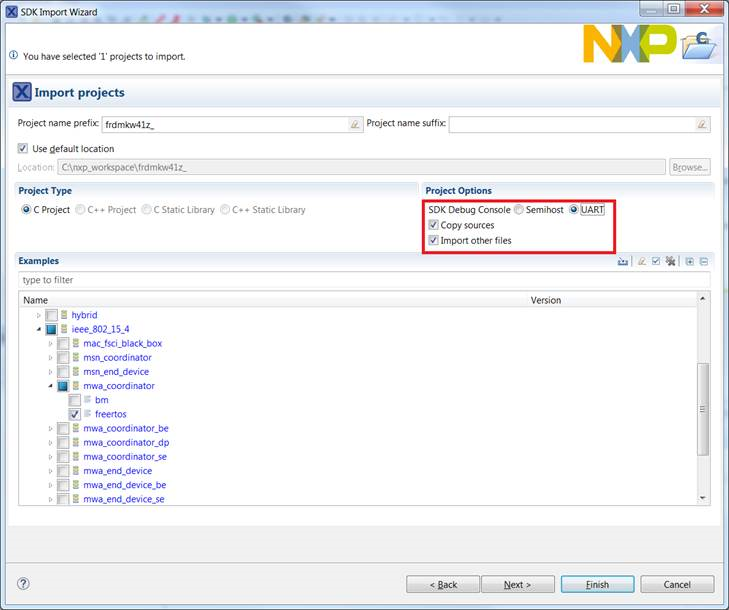

2. In “3. Build, Run” tab, as part of building, below is snapshot from Video.
But in my tool it is shown as below. I changed to UART. Are these settings are fine ??
I am using ieee_802_15_4 -> mwa_coordinator (with freertos option).

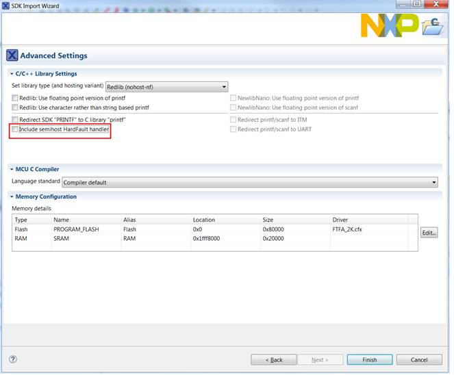

3. I unchecked “Include semihost HardFault handler”. Is this fine ??
Whereas in video this option is not present.

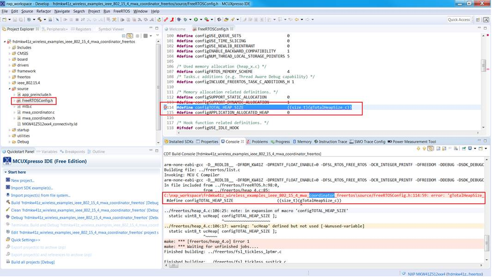

4. If I build, I am getting compiler errors.

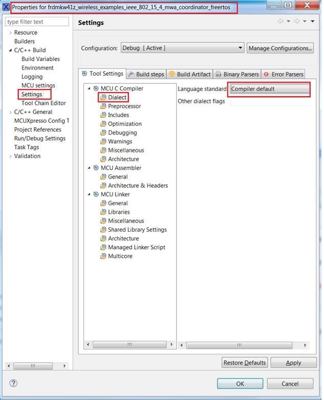

5. I am not sure why these errors are coming (In few cases, include files are not included. These include files are under compile time macros. But why these macros are enabled by default). Even if I change compiler, from “Compiler default” to “-std=gnu99” still I am getting same errors. Are there any settings to be changed in latest IDE so that macros are enabled ??

Yes, that's right. So select the project you're interested in, and then select at least one other project.

I saw this issue in MCUXpressoIDE_10.1.0_589.  The workaround (2 projects) fixed it.
I then downloaded MCUXpressoIDE_10.1.1_606.  With that build, i could load a single project, and it would build.
Should mention that in both cases, I had to resolve a problem with the HardFault_Handler.  Either had to add the flag (mentioned in the code) "__SEMIHOST_HARDFAULT_DISABLE" to the build, or comment out the handler code in debug_log.c .

Can you please give more details on "import 2 or more projects at the same time". Do you mean importing more than one example from SDK.
- Vishnu Beema

anthony_huereca
Hi Vishnu,
  There's a bug in the 10.1 MCUXpresso IDE release when importing connectivity projects. The work-around is to important 2 (or more) projects at the same time. Then the project settings will be imported correctly, and the project will compile.
  This will be fixed in the next release of MCUXpresso IDE.
