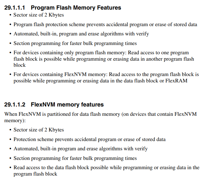

Short Question: Can FlexNvM(D-Flash) contain a region defined as NvM Block and another region defined as program data? Is it perfectly equivalent to using P-Flash for program data?
Hi All,

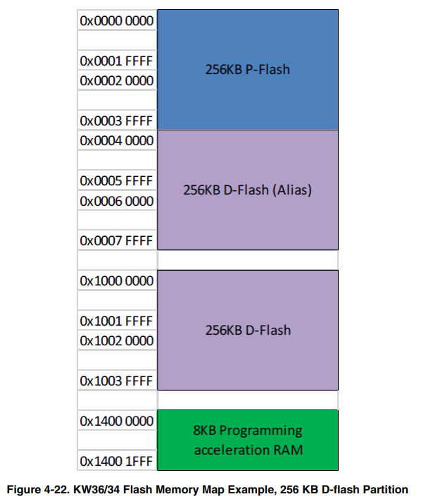

I develop an application for MKW36A512 and am defining the regions for code, data and NVM.
The micro has 2x256Kb Flash defined as follows:
I don't need to use the full 256 Kb of D-Flash to store data (I actually need only a small part to be use as long term memory) and plan to increase the size of the region dedicated to program code. From the reference manual: https://www.nxp.com/docs/en/reference-manual/MKW36A512RM.pdf.
Is this something that can be done without any concern, or using FlexNvM to store program code brings something that should be considered?
TLDR: Can D-Flash contain a region defined as NvM Block and another region defined as program data? Is it perfectly equivalent to using P-Flash for program data?

Hi Please check the following community documents
Creating an OTAP Image Preserving the Memory Content for KW36
and
https://community.nxp.com/docs/DOC-342493
