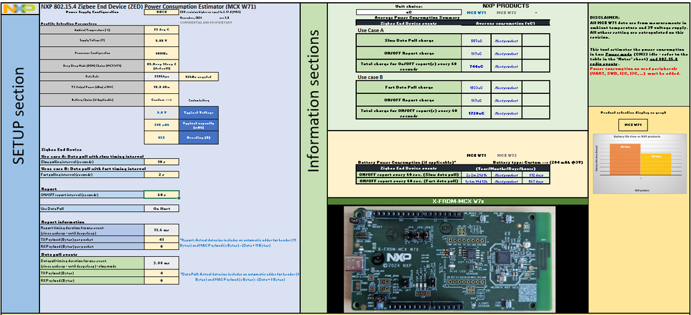

  3. 802.15.4 Matter for the MCX W71 product in standalone (IIoT).

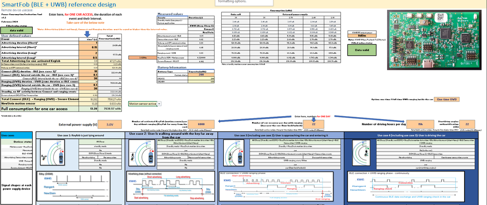

  4. SmartFob application (BLE/KW45; UWB Ranger4; SE; motion sensor) (Automotive)

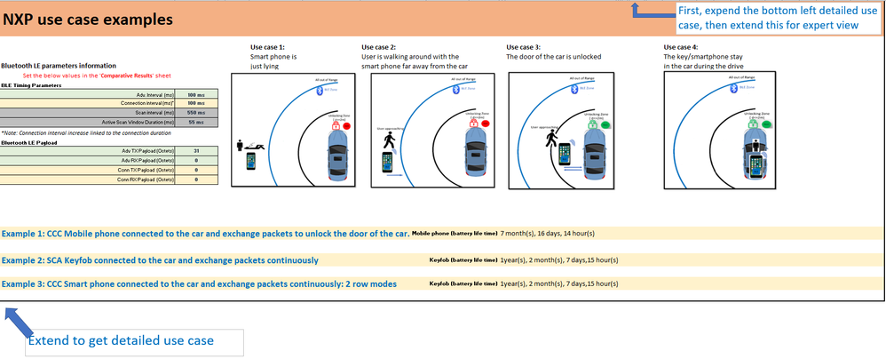

1. KW35/KW38/KW45 Bluetooth LE Power profiles
This tool includes 3 different use cases to get a rough estimation of the Anchor and Keyfob/Smartphone power consumptions:
   1- CCC mobile phone connected to the car and exchange packets to unlock the door of the car
   2- SCA Keyfob connected to the car and exchange packets continuously
   3- CCC Smartphone connected to the car and exchange packets continuously : 2 row modes

3. MATTER 802.15.4 MCX W71 Power profile
4. Smartfob Power profile

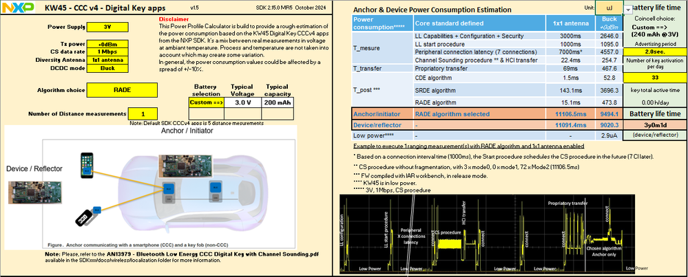

5. CCCv4 localization power profile
2 automotive applications example are available in the KW45 SDK:
...\kw45b41zevk\wireless_examples\bluetooth\digital_key_car_anchor_cs
...\kw45b41zevk\wireless_examples\bluetooth\digital_key_device_cs
2 IIoT applications example are available in the MCX W71 SDK:
...\MCX W71\boards\k32w148evk\wireless_examples\bluetooth\loc_reader
...\MCX W71\boards\k32w148evk\wireless_examples\bluetooth\loc_user_device
