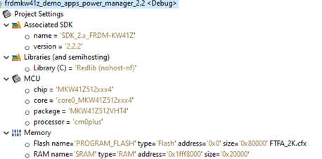

I'm debugging through the usb port, so I left the board as is in this configuration :

I tried the newest SDK 2.2.2.
I have run into the exact same issues. One thing I noticed too is that the option E (VLPW) behave the same bad way the others do in some occasion but I couldn't figure out if there was a pattern. It's not instantaneous as the others though, and when it does so the device go back in run mode instead of VLPR (same as the others).

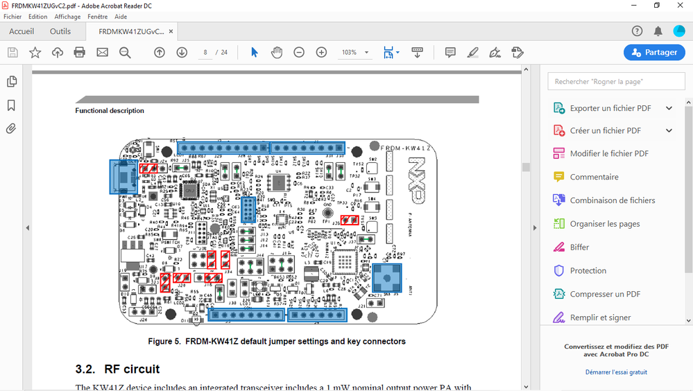

After some close examination of the new C2 Rev. FRDM KW41Z board, I was able to determine the cause of the behavior you were reporting.
Revision C2 no longer has some of the jumper headers soldered to the board, such as the DCDC configuration jumpers.

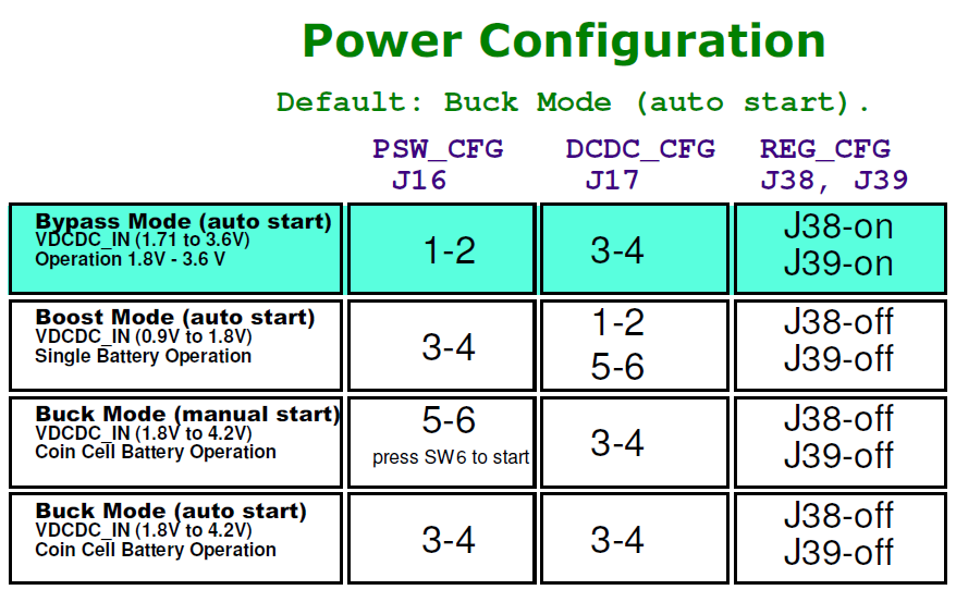

Instead, these jumpers come pre-connected to set the board to a Buck Auto-Start DCDC configuration, which doesn't allow the use of some of the VLLSx power modes.
To allow the use of these power modes, the DCDC should be configured in bypass mode by physically cutting the default connections on J16, and soldering jumper headers to perform the following connections:
More information about these new board configurations can be read in the FRDM-KW41Z Freedom Development Board User's Guide for Rev. C2 (FRDMKW41ZUGvC2).

Setting J16 to 1-2 configuration will send the PSWITCH pin of the MCU to GND, indicating Bypass mode to the MCU:
Please also note that jumpers J38 and J39 by default come open, and for Bypass mode to work correctly, should also be shorted/closed:
Please let me know if you continue to have issues.
