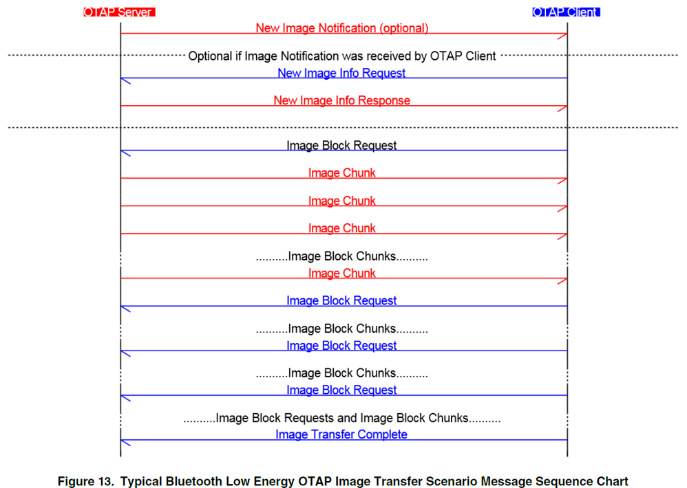

KW36 OTA update from mobile phone to peripheral that use IOT Toolbox(APP) on the mobile phone side.
If we want to develop our own APP on phone,
What information can NXP provide (e.g. flow chat、PDF ...) for our reference?

Sebastian_Del_Rio
Hi Daniel, I hope you're doing well!
Information about the OTAP process, as well as a general event flowchart can be found in section 11 of the BLE Application Developer's Guide; specifically, section 11.3.3 shows the following chart explaining the general flow of the OTAP procedure from Server to Client:
This document can be found in the following path of the SDK package:
<…\SDK_2.2.2_FRDM-KW36 - MCUXpresso\docs\wireless\Bluetooth\Bluetooth Low Energy Application Developer Guide.pdf>
Please let me know if you need any more information, please let me know.
