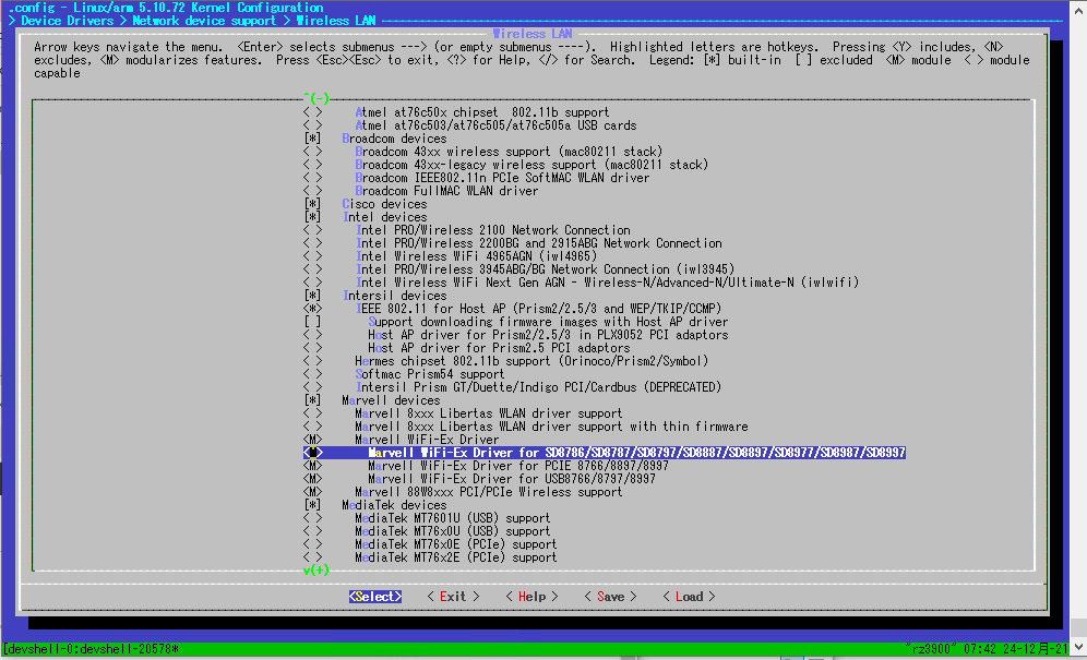

HiroakiOkoshi
Do you mean this selecting?
Thanks.

weidong_sun
Hello @HiroakiOkoshi ,
sorry, correct it.
In kernel, it's Marvel driver, not latest one. below is an example for getting driver:
--driver
#git clone http://source.codeaurora.org/external/imx/mwifiex.git
#git tag
#git checkout lf-5.10.72_2.2.0
--firmware
https://github.com/NXP/imx-firmware/tree/lf-5.10.72_2.2.0/nxp
you can select related driver and firmware according to your kernel version. and compile it separately.
Have a good day!
weidong

weidong_sun
See Below steps, please!
1. exporting cross-compiling toolchain using Yocto
open i.MX_Linux_Users_Guide.pdf, and search standalone, you will see how to export the toolchain.
2. installing the toolchain(.sh file) to /opt directory.
3. using source command to configure environment, like below
enter into wifi's wlan_src subdirectory, and run :
#source /opt/fsl-imx-fb/5.4-zeus/environment-setup-cortexa9t2hf-neon-poky-linux-gnueabi
[Note]
above is mine , yours should be a little different.
4. setting KERNELDIR
It is in yocot build(tmp/work....) directory,
5. run make build or make
after compilation is done, mlan.ko & moal.ko are generated.
these 2 files are drivers.
Have a good day!
weidong

HiroakiOkoshi
Thanks weidong.
However ...
  1. I could build driver.(*1)
  2. I can't find sd8987.ko in bin_wlan directory.(*1)
  3. Building from mwifiex generated mlan.ko and moal.ko.   mlan.ko and moal.ko were prepared.(*2)
  4. If I think about another point of view, I suspect that there is a problem with the device tree selection, not with the driver build.
  5. I checked dmesg and it seems that sdio is not found. (*3)
  6. If so, which of should I select the dtb file, JODY-W2 (88W8987) is connected to SD3 of imx6qsabresd. (*4)
(*1)
$ make build
make -C /work/imx-yocto-bsp-imx-5.10.72-2.2.0.xml/build-fb/tmp/work-shared/imx6qsabresd/kernel-build-artifacts/ M=/work/imx-yocto-bsp-imx-5.10.72-2.2.0.xml/wifi_src/mwifiex/mxm_wifiex/wlan_src ARCH=arm CROSS_COMPILE=arm
make[1]: ディレクトリ '/work/imx-yocto-bsp-imx-5.10.72-2.2.0.xml/build-fb/tmp/work-shared/imx6qsabresd/kernel-build-artifacts' に入ります
  CC [M]  /work/imx-yocto-bsp-imx-5.10.72-2.2.0.xml/wifi_src/mwifiex/mxm_wifiex/wlan_src/mlan/mlan_shim.o
  CC [M]  /work/imx-yocto-bsp-imx-5.10.72-2.2.0.xml/wifi_src/mwifiex/mxm_wifiex/wlan_src/mlan/mlan_init.o
arm-poky-linux-gnueabi-gcc  -mthumb -mfpu=neon -mfloat-abi=hard -mcpu=cortex-a9 -fstack-protector-strong  -O2 -D_FORTIFY_SOURCE=2 -Wformat -Wformat-security -Werror=format-security --sysroot=/opt/fsl-imx-fb/5.10-hardkno
make[1]: ディレクトリ '/work/imx-yocto-bsp-imx-5.10.72-2.2.0.xml/wifi_src/mwifiex/mxm_wifiex/wlan_src/mapp/mlanutl' から出ます
user@rz3900:/work/imx-yocto-bsp-imx-5.10.72-2.2.0.xml/wifi_src/mwifiex/mxm_wifiex/wlan_src$ ls  -al ../bin_wlan/
total 1748
drwxrwxr-x 3 user user   4096 Dec 28 17:01 .
drwxrwxr-x 4 user user   4096 Dec 28 17:01 ..
-rw-rw-r-- 1 user user  62609 Dec 28 17:52 README_MLAN
drwxrwxr-x 2 user user   4096 Dec 28 17:01 config
-rw-rw-r-- 1 user user    302 Dec 28 16:51 load
-rw-rw-r-- 1 user user 681056 Dec 28 17:52 mlan.ko
-rwxrwxr-x 1 user user  51100 Dec 28 17:52 mlanutl
-rw-rw-r-- 1 user user 964364 Dec 28 17:52 moal.ko
-rw-rw-r-- 1 user user    356 Dec 28 16:51 unload
 (*2)
root@imx6qpdlsolox:~# ls -al /lib/modules/5.10.72-lts-5.10.y+ga68e31b63f86/extra/
total 1724
drwxr-xr-x 2 root root   4096 Mar  9  2018 .
drwxr-xr-x 4 root root   4096 Dec 23 09:37 ..
-rw-r--r-- 1 root root  63324 Mar  9  2018 cryptodev.ko
-rw-r--r-- 1 root root 698792 Mar  9  2018 mlan.ko
-rw-r--r-- 1 root root 987388 Mar  9  2018 moal.ko
(*3)
root@imx6qpdlsolox:~# dmesg | head
[    0.000000] Booting Linux on physical CPU 0x0
[    0.000000] Linux version 5.10.72-lts-5.10.y+ga68e31b63f86 (oe-user@oe-host) (arm-poky-linux-gnueabi-gcc (GCC) 10.2.0, GNU ld (GNU Binutils) 2.36.1.20210209) #1 SMP PREEMPT Tue Nov 23 06:02:20 UTC 2021
[    0.000000] CPU: ARMv7 Processor [412fc09a] revision 10 (ARMv7), cr=10c5787d
[    0.000000] CPU: PIPT / VIPT nonaliasing data cache, VIPT aliasing instruction cache
[    0.000000] OF: fdt: Machine model: Freescale i.MX6 Quad SABRE Smart Device Board
[    0.000000] Memory policy: Data cache writealloc
[    0.000000] Reserved memory: created CMA memory pool at 0x3c000000, size 320 MiB
[    0.000000] OF: reserved mem: initialized node linux,cma, compatible id shared-dma-pool
[    0.000000] Zone ranges:
[    0.000000]   Normal   [mem 0x0000000010000000-0x000000004fffffff]
(*4)
root@imx6qpdlsolox:/lib/modules/5.10.72-lts-5.10.y+ga68e31b63f86/extra# ls -al /run/media/mmcblk3p1/imx6q-sabresd*
-rwxrwx--- 1 root disk 54201 Apr  5  2011 /run/media/mmcblk3p1/imx6q-sabresd-btwifi.dtb
-rwxrwx--- 1 root disk 53385 Apr  5  2011 /run/media/mmcblk3p1/imx6q-sabresd-enetirq.dtb
-rwxrwx--- 1 root disk 53249 Apr  5  2011 /run/media/mmcblk3p1/imx6q-sabresd-hdcp.dtb
-rwxrwx--- 1 root disk 53176 Apr  5  2011 /run/media/mmcblk3p1/imx6q-sabresd-ldo.dtb
-rwxrwx--- 1 root disk 53252 Apr  5  2011 /run/media/mmcblk3p1/imx6q-sabresd-pcie-ep.dtb
-rwxrwx--- 1 root disk 53252 Apr  5  2011 /run/media/mmcblk3p1/imx6q-sabresd-pcie.dtb
-rwxrwx--- 1 root disk 53340 Apr  5  2011 /run/media/mmcblk3p1/imx6q-sabresd-uart.dtb
-rwxrwx--- 1 root disk 53256 Dec 24 11:05 /run/media/mmcblk3p1/imx6q-sabresd.dtb
-rwxrwx--- 1 root disk 53256 Apr  5  2011 /run/media/mmcblk3p1/imx6q-sabresd.dtb.org
Thanks mush support.
Hiroaki.
