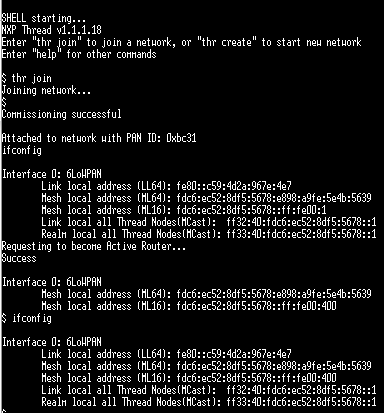

ifconfig
Thread_Shell demo
Thread_KW_Tun demo
Joiner FRDM-KW41Z (shell)
  • Join the Thread network
  • Verify IP addresses
  • Ping Eth LAN interface on OpenWrt router to verify “Internet” connectivity

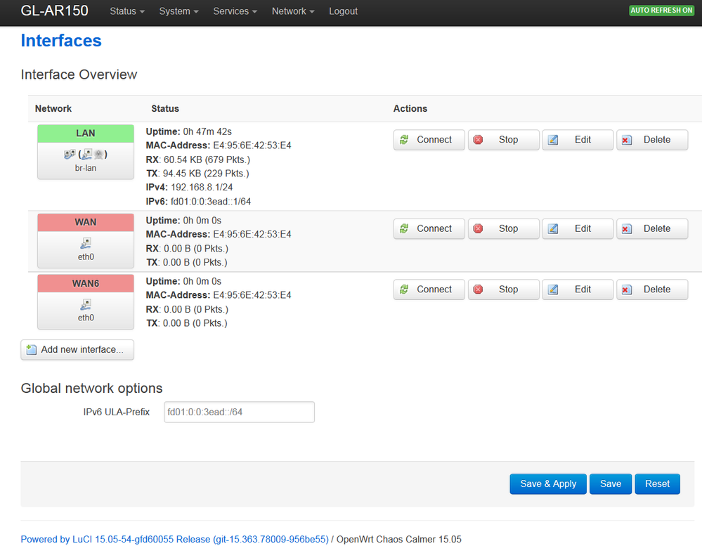

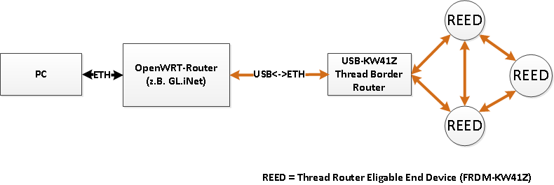

Thanks for your little Tutorial here! Maybe you could help me with my similar setup. What i want to do, is sending ipv6 packets from my PC, over a OpenWRT Router (GL AR-150), connected to a USB-KW41Z running the border_router example from SDK, to a Node in a Thread Network, which is running as Router Eligable End Device, and back. The K22F on the USB-KW41Z is running the RNDIS software, so that the USB Stick is recognized as ethernet interface.

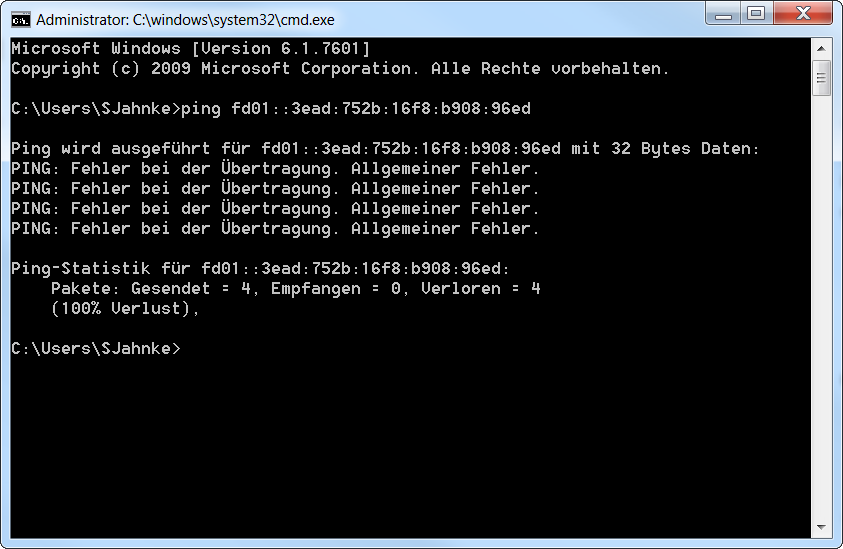

If I'm trying to ping the REED's in the Thread Network from my PC it won't work. Here is the ULA from the Node which i want to ping.
And here you can see the config and IPv6 ULA--Prefix from the OPenWRT Router.

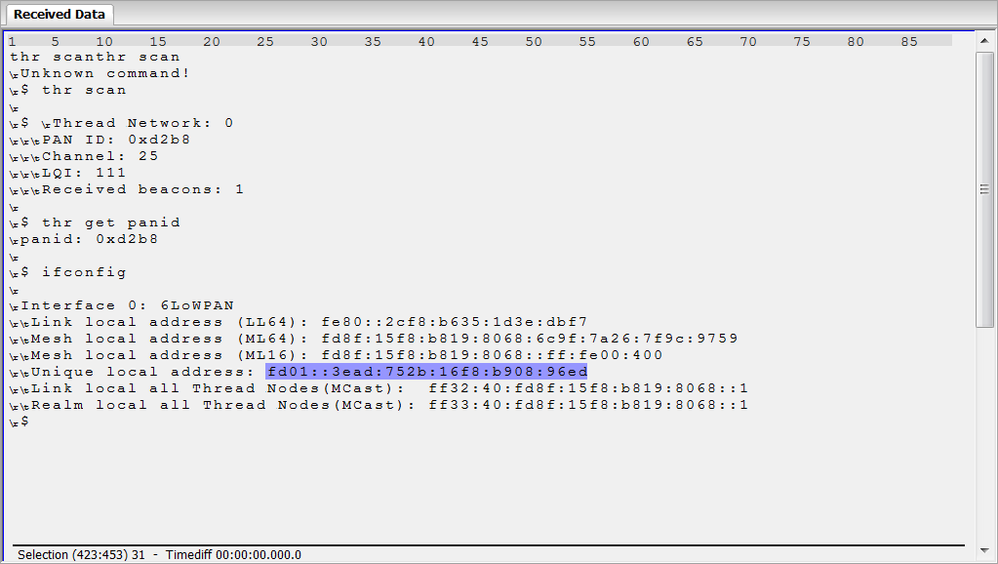

If I'm now try to ping the IPv6 address from the REED Thread Node i get the following.
Is there maybe something wrong with ULA-Präfix configuration on the Thread-Node, the USB-KW41Z or the OpenWRT-Router? Or do i have to keep an special order for initializing the devices? If I'm trying to ping the device without the OpenWRT Router between the PC and the USB-KW41Z and stick the USB-KW41Z directly to the PC the ping is successful. It would be awesome if someone could help me with this issue.
Steffen

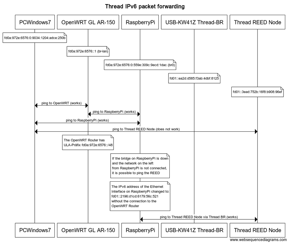

EDIT: After some testing, with another configuration than above, i found out, that the USB-KW41Z and the Thread Node don't get an IPv6 ULA Präfix from the OpenWRT Router. But that is exactly what should happen right? I added a RaspberryPi between the OpenWRT Router and the USB-KW41Z Border Router, to have better access to the Border Router and start a Thread Network for example. To forward the packets from my WindowsPC to the Thread Node I added a bridge (br0), which is forwarding the packets between the ethernet interface of the Pi and the USB-KW41Z acting as ethernet interface. Here is the setup.
What i tried is:
  • First start the OpenWRT Router, and check the connections with a ping between the PC OpenWRT Router and Raspberry Pi (see image above)
  • Attach the USB-KW41Z BorderRouter to the RaspberryPi and started the Thread Network via the PCAPTest script in the USB-KW41Z SDK
  • and finally joined a Thread Node and try to ping it from the PC (see image above)
As you can see in the image above, the  Border Router(fd01::ea2d:d585:f3ab:4dbf:8124) and the Thread Node(fd01::3ead:752b:16f8:b908:96ed) don't have the same IPV6 ULA Präfix(fd0a:972e:6576::/48) than the OpenWRT Router, PC and Raspberry Pi? So i can not access the ThreadNode via the OpenWRT Router ?! But if I'm disconnect the connection between the OpenWRT Router and the Raspberry Pi and bring the br0 on the Pi down, I'm able to ping the Thread Node from the Pi.
Could you tell me what do i have to do, that every member of the network get the same ULA Präfix, so that they can communicate? Is there a documentation for this usecase, because i can't find some?
Thanks a lot!
Steffen
Hello Steffen,
The use case you describe is similar to “11.4 External routing via Ethernet on FRDM-K64F – ND6 host mode and OpenWrt” from the Kinetis Thread Stack Demo Applications User's Guide document but with the USB-KW41Z RNDIS interface on a OpenWRT router. You'll just need to bridge together the LAN and RNDIS interfaces. See below:
Steps on OpenWrt
  1. Install RNDIS driver support – see https://wiki.openwrt.org/doc/howto/usb.tethering
# opkg update
# opkg install kmod-usb-net kmod-usb-net-rndis kmod-usb-net-cdc-ether usbutils udev
  1. Assuming eth2 is created when you plug-in USB-KW41Z
# echo 0 >  /sys/devices/virtual/net/br-lan/bridge/multicast_snooping
# brctl addif br-lan eth2
# ifconfig eth2 up
# brctl show
Steps on USB-KW41Z border router project
  1. Enable USBENET_HOST instead of USBENET_ROUTER
.../source/config.h
#if defined(CPU_MKW24D512VHA5) || defined(USB_KW41)
#define USBENET_ROUTER    0       //from 1
#define USBENET_HOST      1       //from 0‍‍‍
Hope this helps.
JC

after getting the connection from my Windows PC to the Thread Node, via the OpenWRT Router and the RaspberryPi i want to use the Thread Commisssioning App from the Play Store on my Android device to add other Thread Nodes to the Network. I switched on the Wifi on the OpenWRT Router and connected the android device, to the  OpenWRT Router. But i cant find a Thread Border Router when opening the Thread App. I also checked that the wlan interface, I am connected
with, is also in the br-lan bridge, which the Border Router is also connected to.
Are there any configurations on the OpenWRT or the Borer Router, I have to do before i could see the Border Router?
Steffen
Hello Steffen,
On the remote device, you require to add a route to the Thread network. In Linux, this is done with the following commands, assuming eth0 is the interface connected to the router:
$ sudo sysctl -w net.ipv6.conf.eth0.accept_ra=2
$ sudo sysctl -w net.ipv6.conf.eth0.accept_ra_rt_info_max_plen=64
$ rdisc6 eth0
rdisc6 is available after you install ndisc6 from apt-get.
Then you should see a new route in Linux, something like:
2001:2002:2003::/48 via fe80::e695:6eff:fe40:6e1c dev eth0  proto ra  metric 1024  expires 7082sec
You can confirm the route was added with the following command:
$ip -6 r
See: Linux, IPv6, router advertisements and forwarding – The ongoing struggle
On a Windows PC, this is done without any additional configuration.
JC

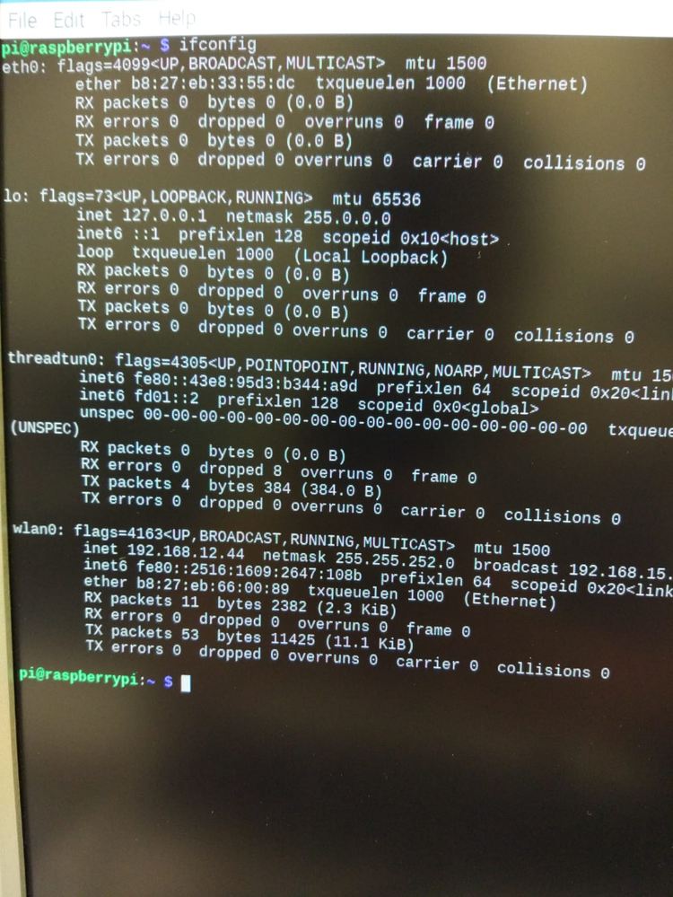

Hi JC,
I have the same configuration as Alessio (Router, Raspberry-Pi, FRDM-KW41Z as Host Controlled Device and a FRDM-KW41Z as a Router Elegible Device) but instead using TAP interface I used TUN interface following the "Kinetis FSCI Host Application Programing interface" guide, everething works fine, I am able to ping the Thread node from my Raspberry-Pi, and I used the CoAPThon python library to communicate to nodes over coap and it works perfectly. At this point as i am using TUN interface i am not able to bridge my raspberry pi to the router, so the computers connected to the router in the same network cannot ping the Thread nodes. For this reason i am looking for changing TUN interface to TAP interface in order to bridge the router (connected to ethernet port eth0 of my Raspberry-PI) and be able to ping Thread Nodes from the computers connected on the router network. However, in your tutorial you said you enabled TAP interface by this command:
  • Create fslthr0 TAP interface:
…/host_sdk/hsdk/demo#   sudo bash make_tap.sh
But in my case i only have in this directory a make_tun.sh file. Where can i find the TAP file or what commands do i suposse to do in order to etablish a TAP interface and bridge to eth0 port in my Raspberry-PI?
Diego C.
Hi Diego,
The latest SDK can be dowloaded from mcuxpresso.com, you need to select the FRDM-KW41Z board and include the wireless stacks.
On the latest version, the VTUN is configured automatically as TAP and is much straight fwd, I need to update this thread with that info.

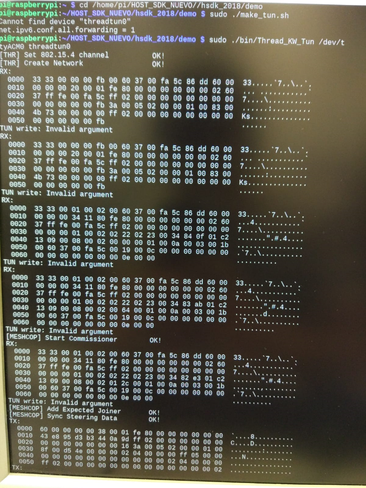

Hi JC,
As I said before I used TUN interface following the "Kinetis FSCI Host Application Programing interface" guide, with the 1.0.2 Connectivity Software running projects on Kinetis Design Studio and everything in TUN interface worked well. Now to test the new SDKs includying TAP interface, I have downloaded the new SDK for MCU Expresso IDE, I tested TAP interface without any router, just to test the connection between Raspi with FRDM-KW41Z (as HCD) and an active router but in this case the node dont get a ULA IPv6 to test connection.
I also made the TUN interface (as I had with the 1.0.2 Connectivity Software) with the new SDK, and the node still don't get the ULA IPv6 address. I attach the command windows from my Pi:
And I attach the terminal of the Active Router node, where I can not find the ULA address:
What could be happening? I only moved to the new SDK.
Best,
Diego C.
Hi Diego,
The TAP interface is now defined by default when enabling THR_SERIAL_TUN.
As seen in this post, the TAP Interface is intended to be used in a topology where a DHCPv6-PD provides a Prefix to the Border Router interface and the devices within the Thread network. If you want to use TAP but keep using static Unique Local Address (ULA), you need to disable THR_SERIAL_TUN_USE_DHCP6_ADDR. As the comment in the macro states: /* When DHCPv6-PD is turned off, local static configuration is used, even in TAP mode */
If you want to enable the TUN interface, you need to disable THR_SERIAL_TUN_ENABLE_ND_HOST and THR_SERIAL_TUN_USE_DHCP6_ADDR in app_serial_tun.h
Hope this helps,
JC
